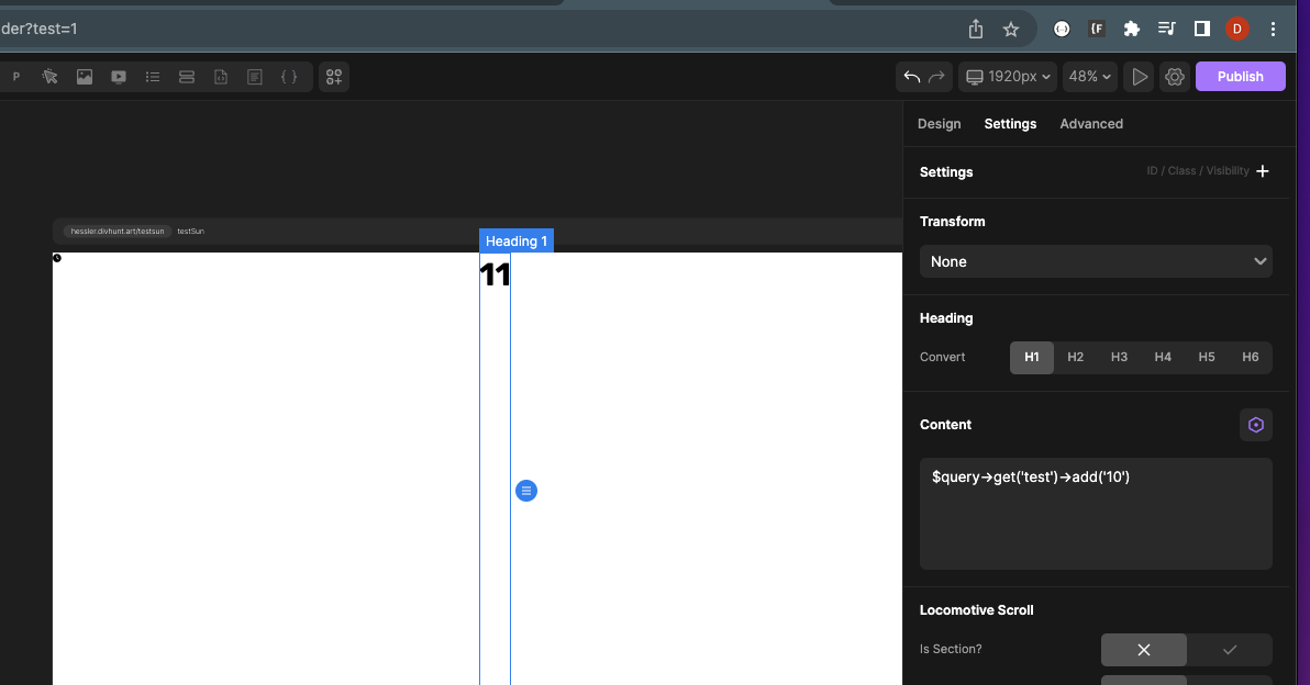

This is interesting :slight_smile:
Let’s start simple, first you need to create plugin inside Creator app (https://hessler.divhunt.art/creator/) - “Marketplace Plugin”
Then you need to create javascript file, just name it let’s say add.js, then paste the code you provided.
That’s it, it should work.
@chelce
As you can see, I already did it for you, only mistake you made is the following:
if(typeof value !== 'String')
    return value;
I think ‘String’ should be lowercase ‘string’
