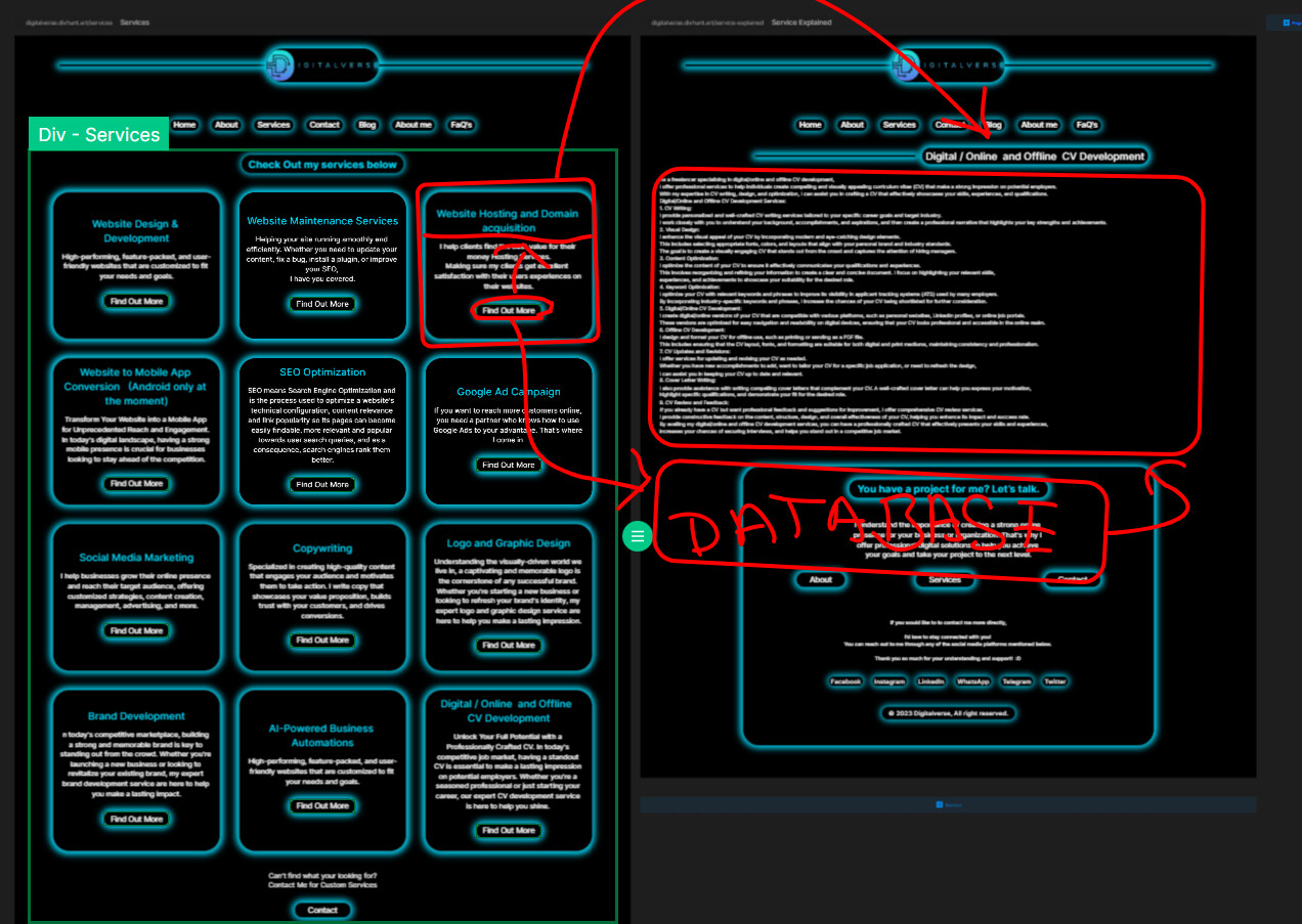

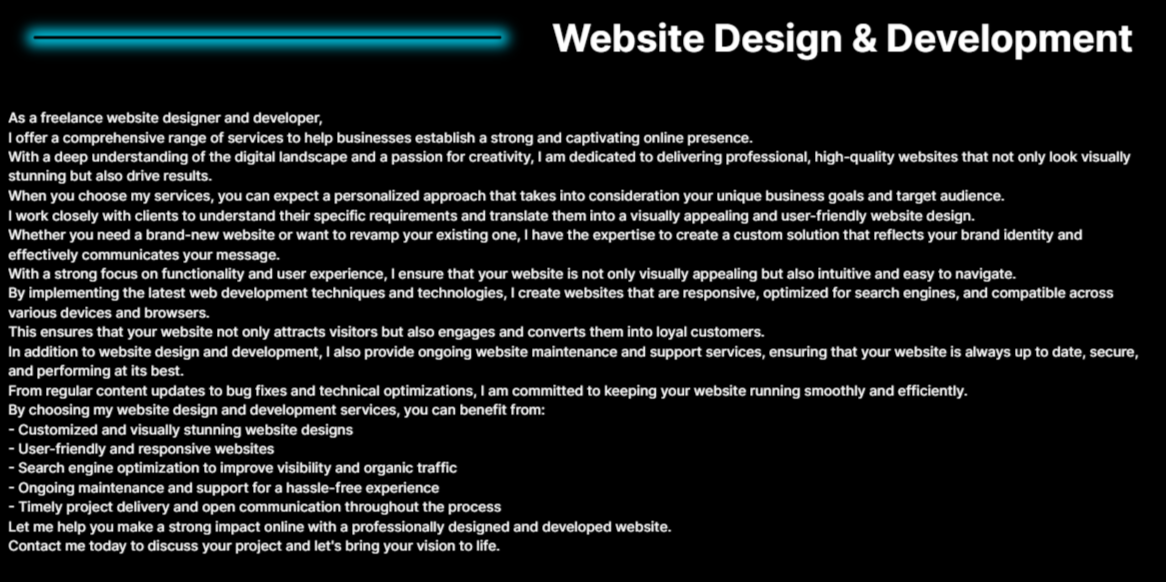

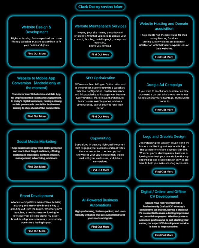

Hi, I have a grid with 12 services conected to database services , grid contains title, short description and 1 button.

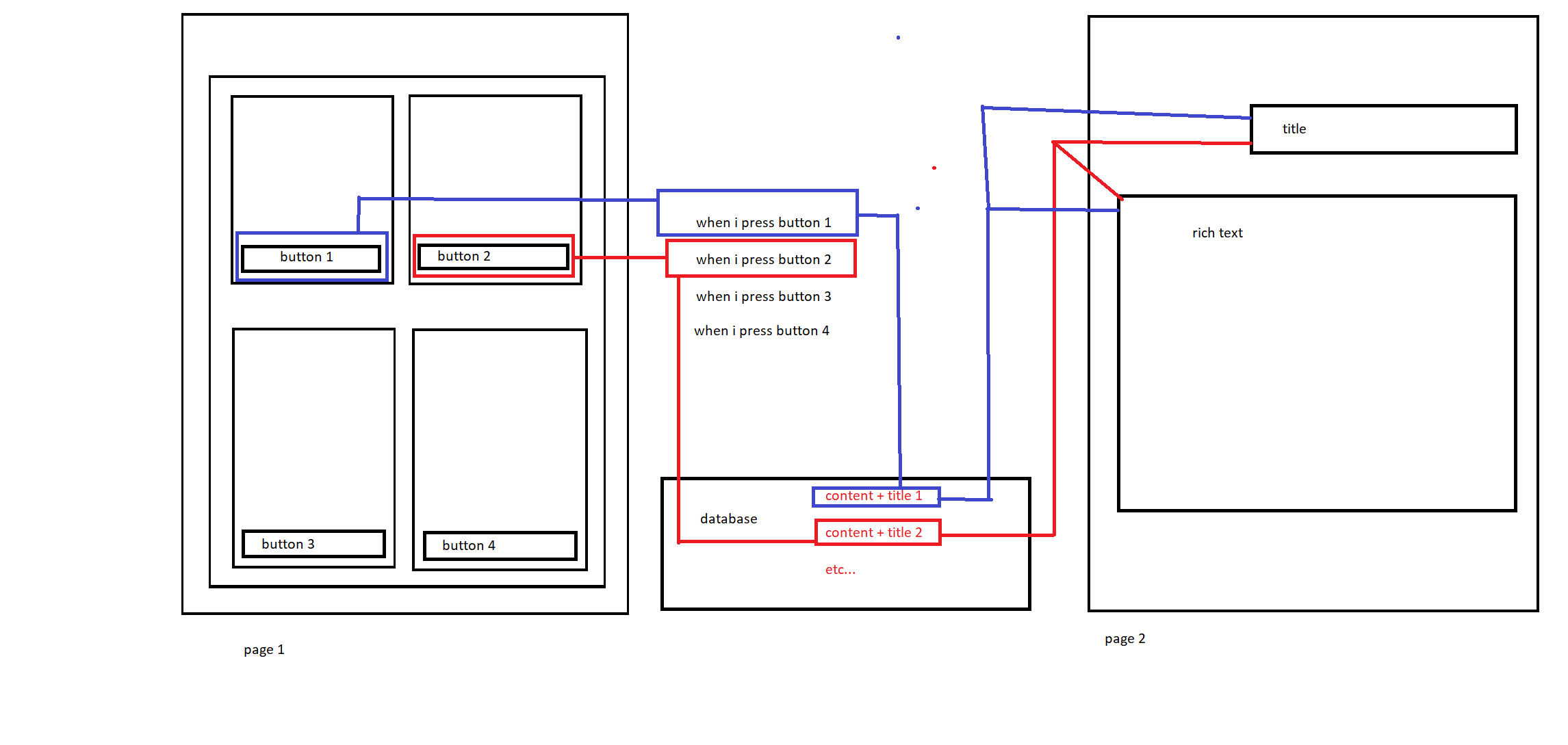

If I make a single page layout with tile and rich text, is it possible to make it like if I click any service button in the grid to send me to the single page and automaticaly give me the title and rich text from the database acording to wich buton I pressed in the grid ?
But to have only 1 page which is modifing constantley according to wich button I press.
Yea I understand this , I just have difficulty with this automation , I don’t know if it’s possible …?
so in the grid if i press on button to take the title and rich text intoo single page ,
do I need to have 12 pages for the grid of 12 buttons or i can do it in only 1 page which can be dinamic , depending on wich button i press

I did that and is working till a point. but I don’t know how to set up my buttons to do like in the picture

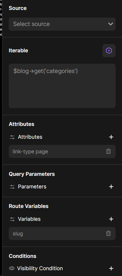

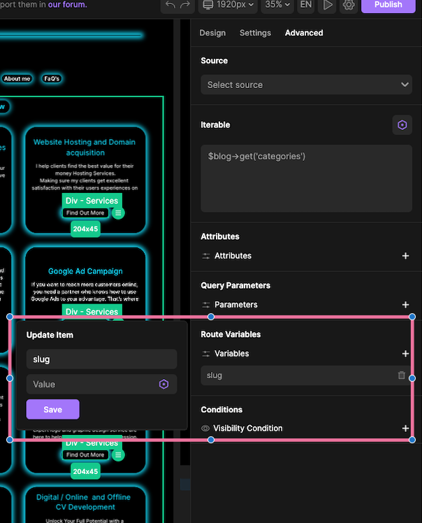

And last step is to configure the slug for buttons.
So click on the buttons (links) and then go to advanced tab, and set the slug (which is variable slug coming from database).
do i need to add something to key?
dejan
July 25, 2023, 9:41pm
12
@KAdrian
Have you selected the link button? You should have seen already predefined key “slug”?
yes i select it like slug , still any button openins the same page

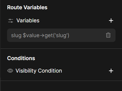

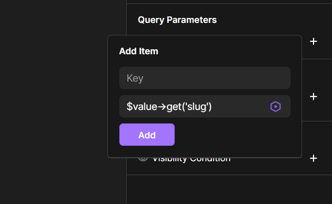

@KAdrian
Yes, click on that slug under Route Variables and configure value to $value->get(‘slug’), then it should work?
Yea I set it now , still not working

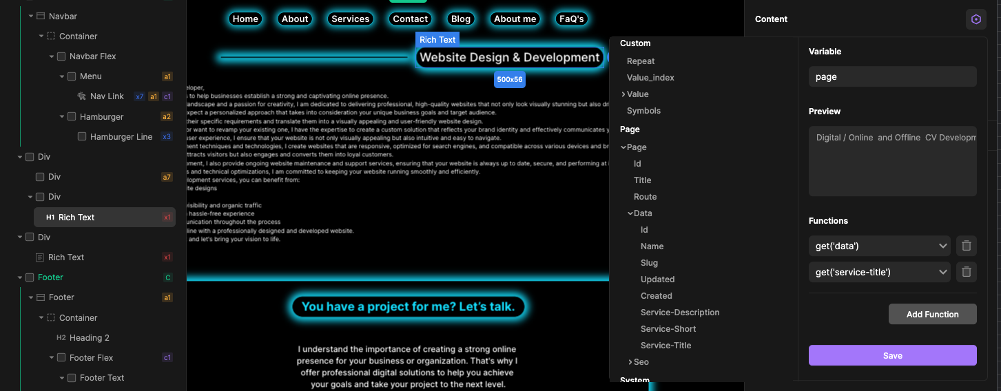

@KAdrian

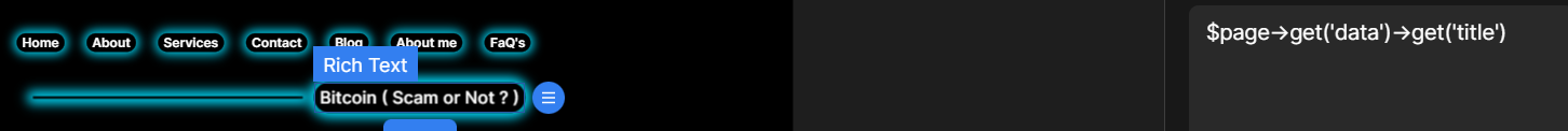

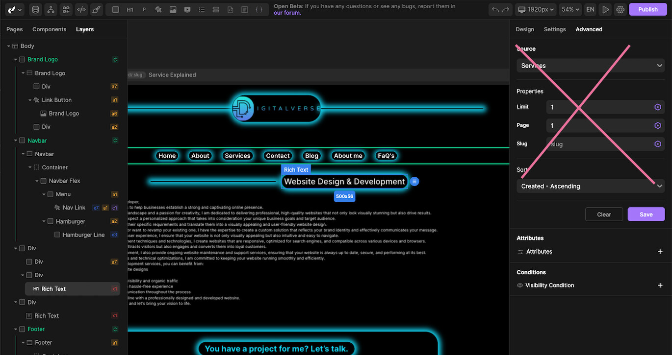

Now all the data for single page are available in variable page > data , so you don’t need to set source like this.
So remove source from that tag, and then in Settings tab > content use page variable like this:
Repeat the same process for rest of the tags for that page, so again, don’t use source, you already have all data available inside page > data variable.
ok , now is connecting to my blog instead of services , how do i change that?

@KAdrian
This is bug from our end, please don’t have multiple pages opened that has source on them. Unpin/close all pages and only work with one with source so you will see proper variable data.
Because the issue is multiple pages are trying to push their data to variable page > data and there’s conflict.
I’ll fix this tomorrow.
It’s working !
