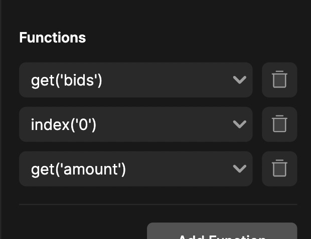

I’m creating an auction site, and this is how I need to ā€œdigā€ into the API responses for multi arrays:
To show how many bids are made:
return ${value->get('bids')}.length
Return how many bids been made and grab the latest bid amount:
Skärmavbild 2023-11-08 kl. 08.01.23
This is how I get it from the API (in this case: 7 bids available):
Skärmavbild 2023-11-08 kl. 08.02.14
Then I use the Visibility Condition in several ways to show if the reserve price is met etc…
