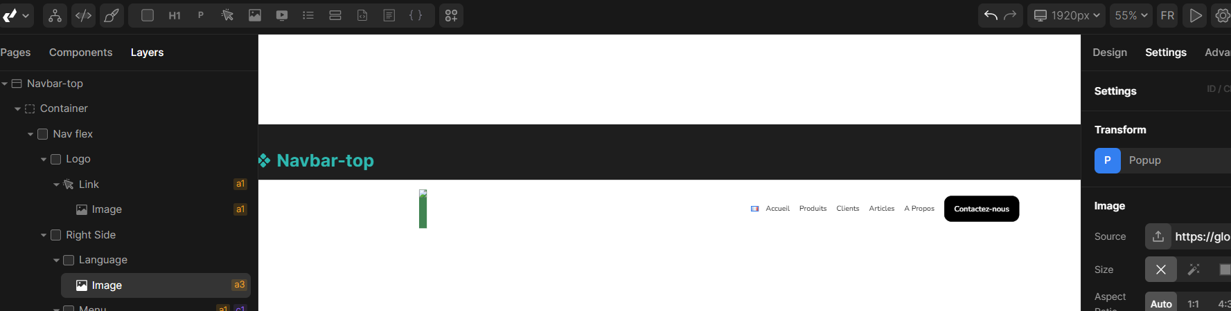

  1. I’ve got a Navbar-top component with a menu where I’ve changed the text for each language (FR EN DE). Here is the screenshot of the french version.
  2. it works well. So now I want to add a flag image. In the screenshot above you see that I’ve added the one for the FR version of the component.

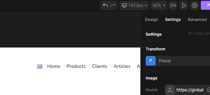

    Now when I’m selecting the EN language and change the image to the UK flag, it will change the image for all languages version of the component. This is not happening for the menu texts.
    See here after the change for EN and the consequence for other languages :

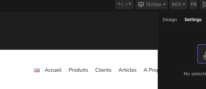

Coming back to FR :

The issue here is that you can only change the text (content) of tags for multiple languages, you can’t change images (attributes).
So in your situation, you could use embed tag for example, as embed tag content (HTML) is treated as text, so it should work on all languages differently.
Inside embed, you should include HTML of icons for example and then repeat same process for all 3 languages.
