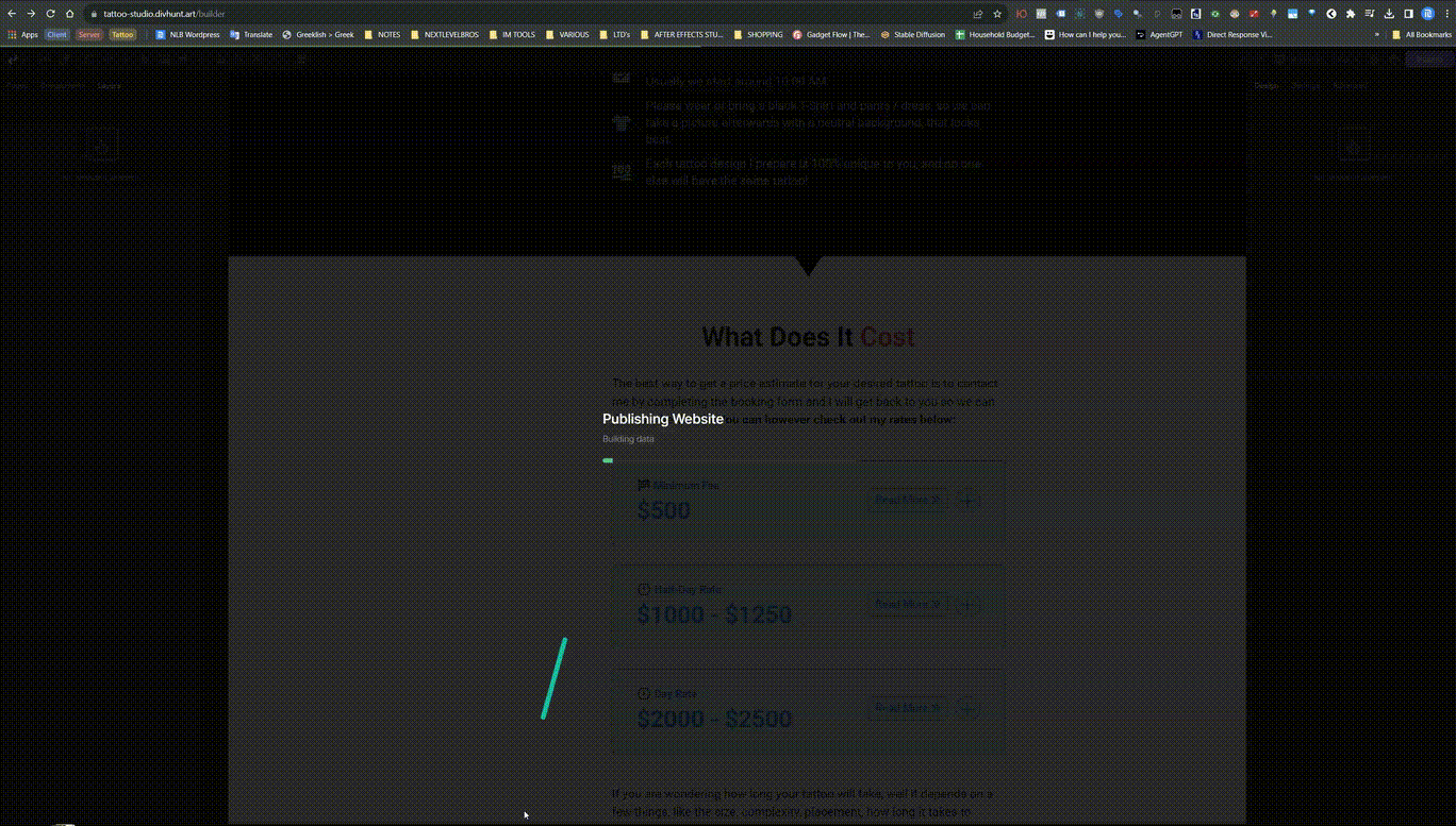

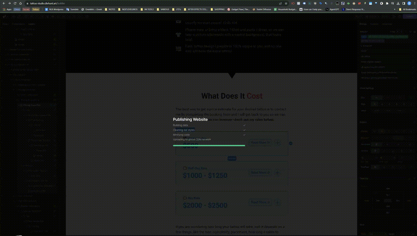

In the past weeks I am experiencing a huge slowdown in publishing speeds and frequent publishing failures compared to when I first started using Divhunt. It seems to be getting worse for me as time passes. The fast publishing speed was one of the things I loved about Divhunt in the beginning.
See video examples of what has become the typical experience for me:
It is very hard to make progress with a website when I cannot publish as needed and it takes multiple very slow attempts to successfuly publish to see how things are on the frontend.
Is anyone else experiencing this?

There are some issues with the CDN and uploading assets, that’s why the publishing is slow. We are working on a fix, it’s not the server infrastructure load issue after all :smiley:
Thanks for that info, I did see some bunny cdn errors in the console. I hope that is easier (and cheaper/free) to fix than server load, good luck with that :muscle:
