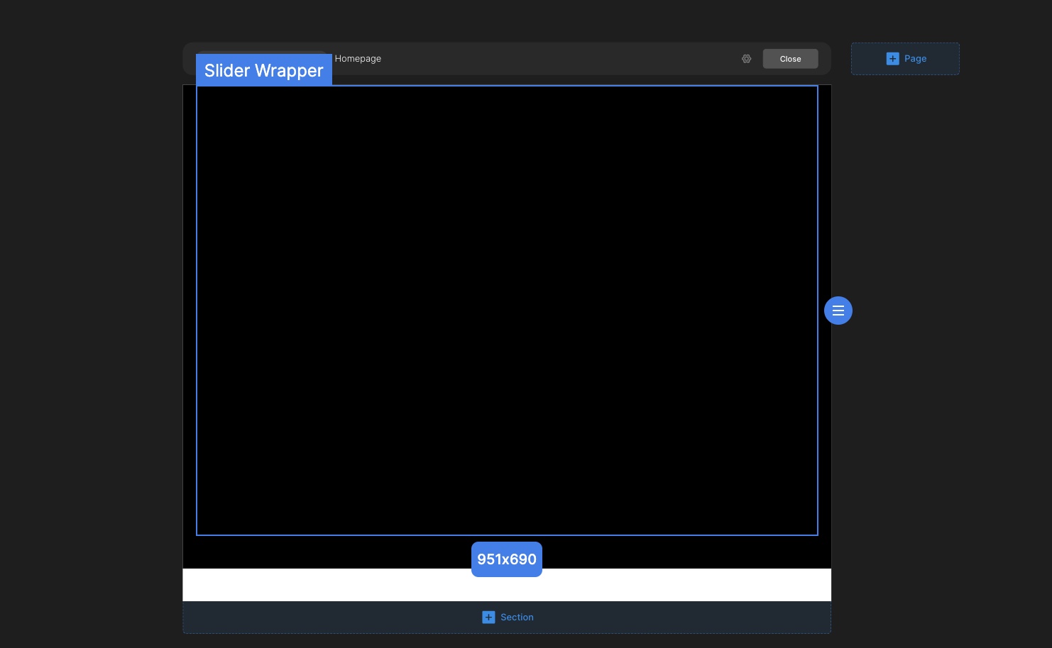

Ronaldo menu doesn't work on responsive modes (tested on 2 websites)
I have tested it on 2 websites and it’s the same.
Only black screen.
Is that a bug?
https://healing-space.divhunt.art/
You need to install Swiper Plugin. Let me know if that works after
It works.

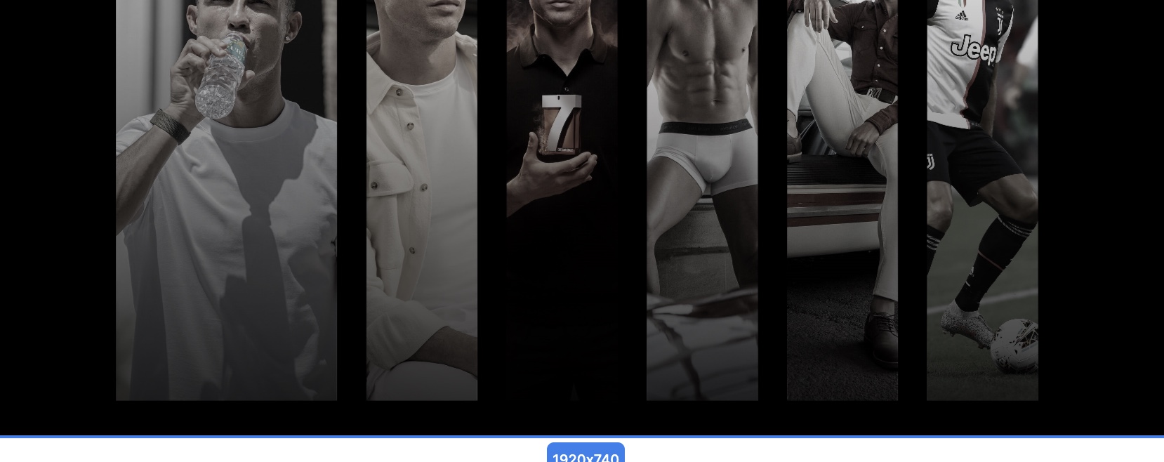

The text is not visible.
How to fix that?
That’s a bug. On text wrapper there is probably class “dh-form-success” applied, you need to remove that class, and instead of that class add class “card-content”
Thanks a lot!

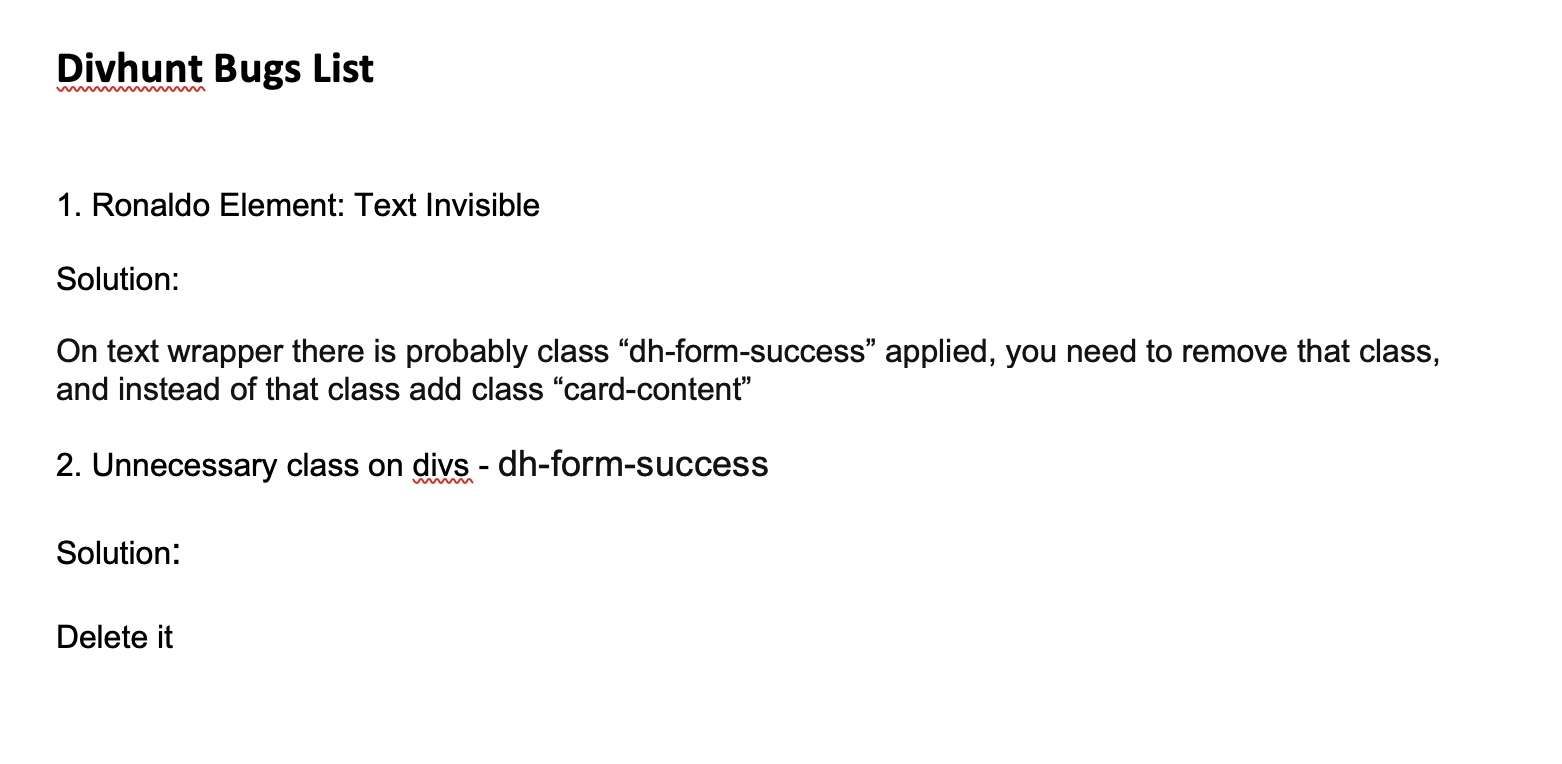

In ANY div that has the class: dh-form-success by default, it is necessary to delete it?
Yeap :slight_smile: That class exists and it should be used for form success state, but when you see it anywhere else other than in form. You should delete it.

I will make a file of all the bugs I discover.
Will send you it later to make sure you know all the bugs.
We keep the list of bugs, so everything you report, we are adding it to the list. :slight_smile: So there’s no need for you to keep track of it, but I appriciate your effort! :slight_smile:
This is also for me for easy access
