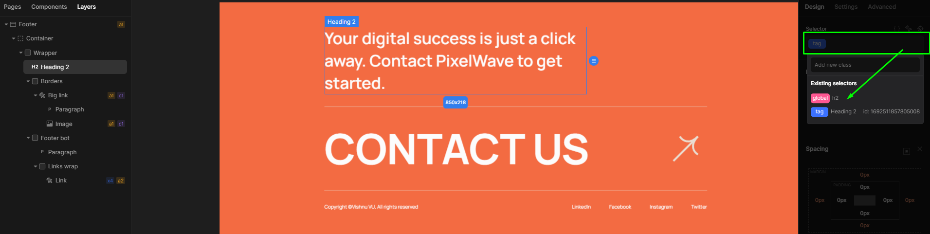

  2. Best way is to edit global h1, h2, etc on your project. If you click on green part on image below, you will get a popup to edit globals of selected element, in this case heading 2.
That same thing you would do in question 1 for body tag.
