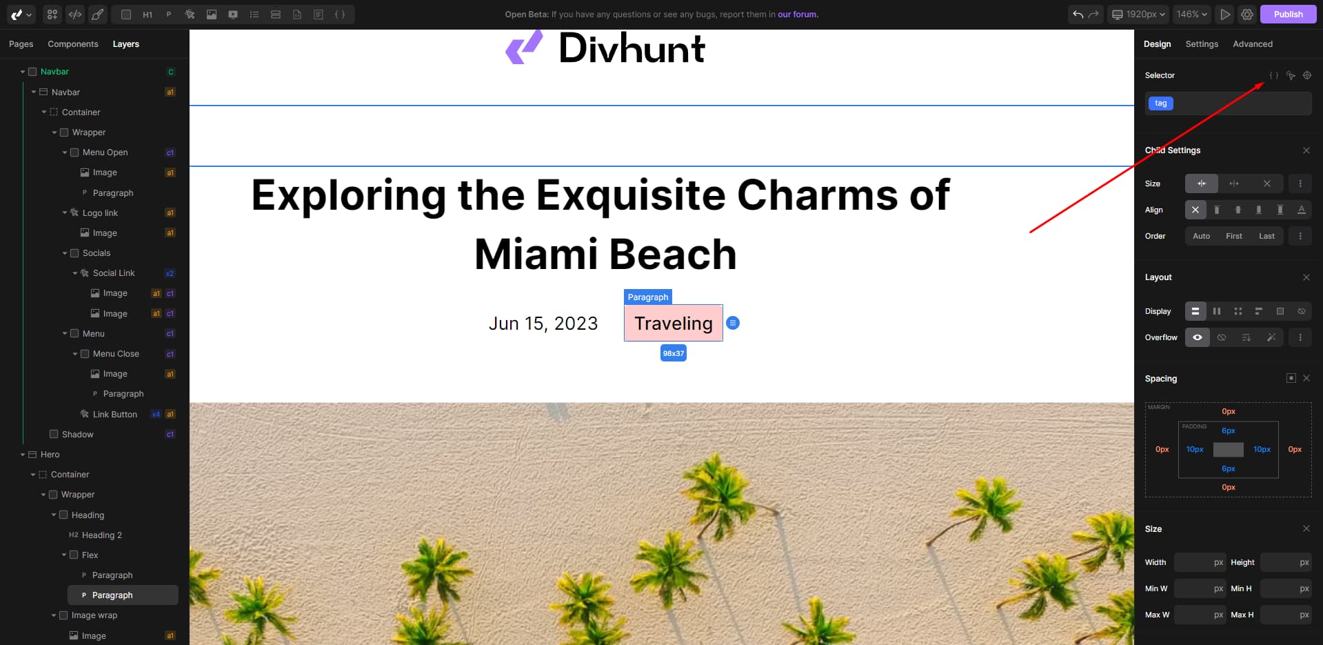

- Just open a custom code from your tag like this(Note: be sure that your tag is selected not your class):

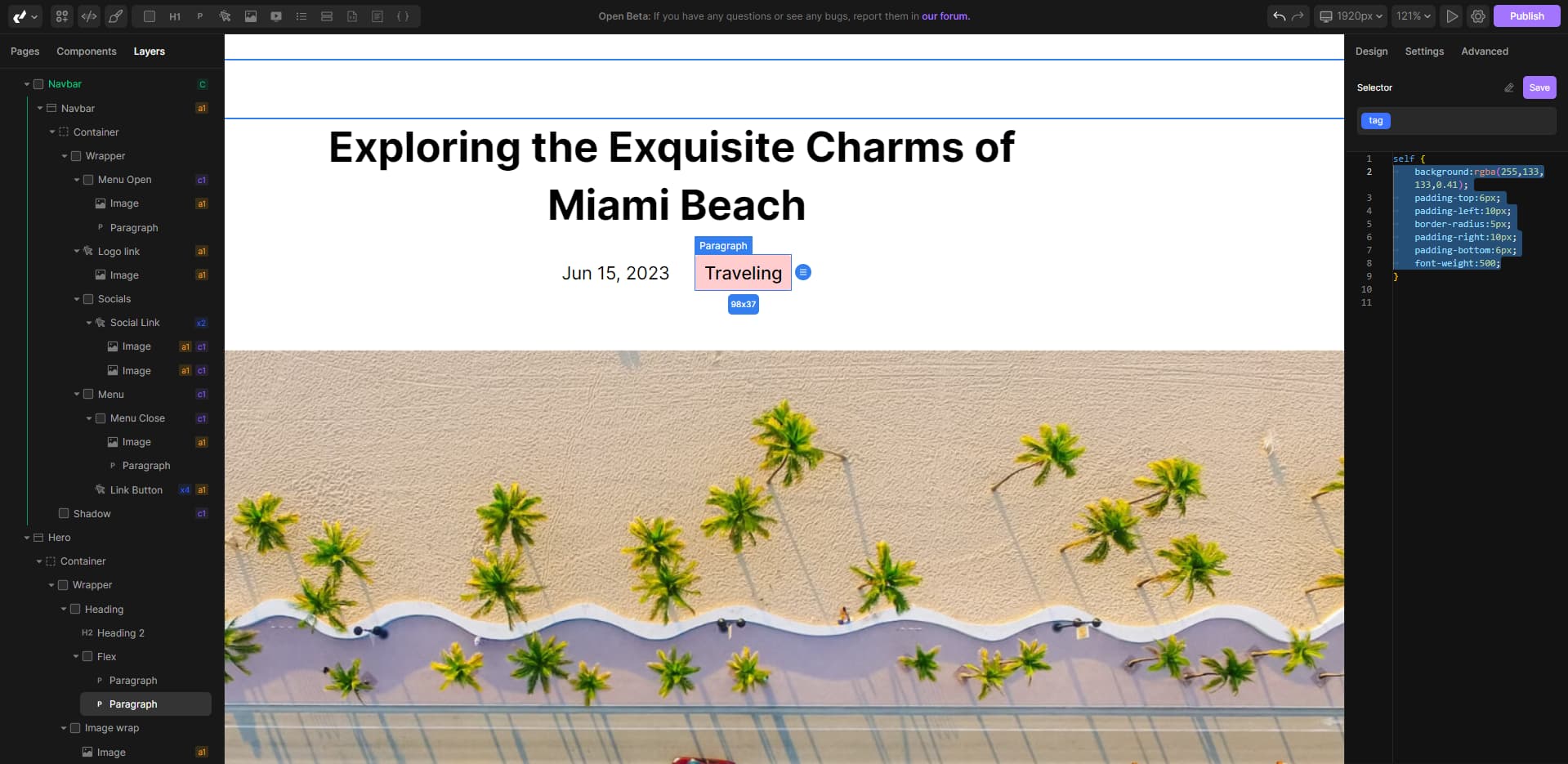

- Copy the code that you want to transfer to a class (you can also cut it because you won’t need it anymore on the tag):

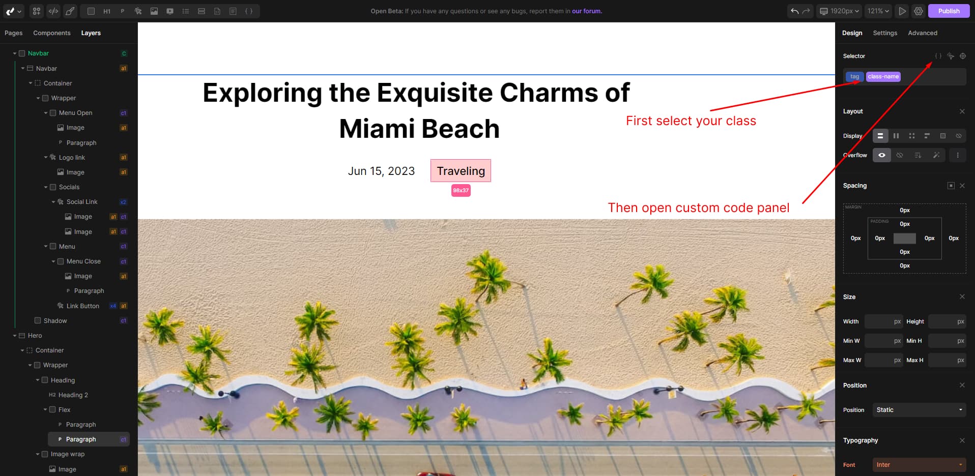

- Open the custom code again but now select your class:

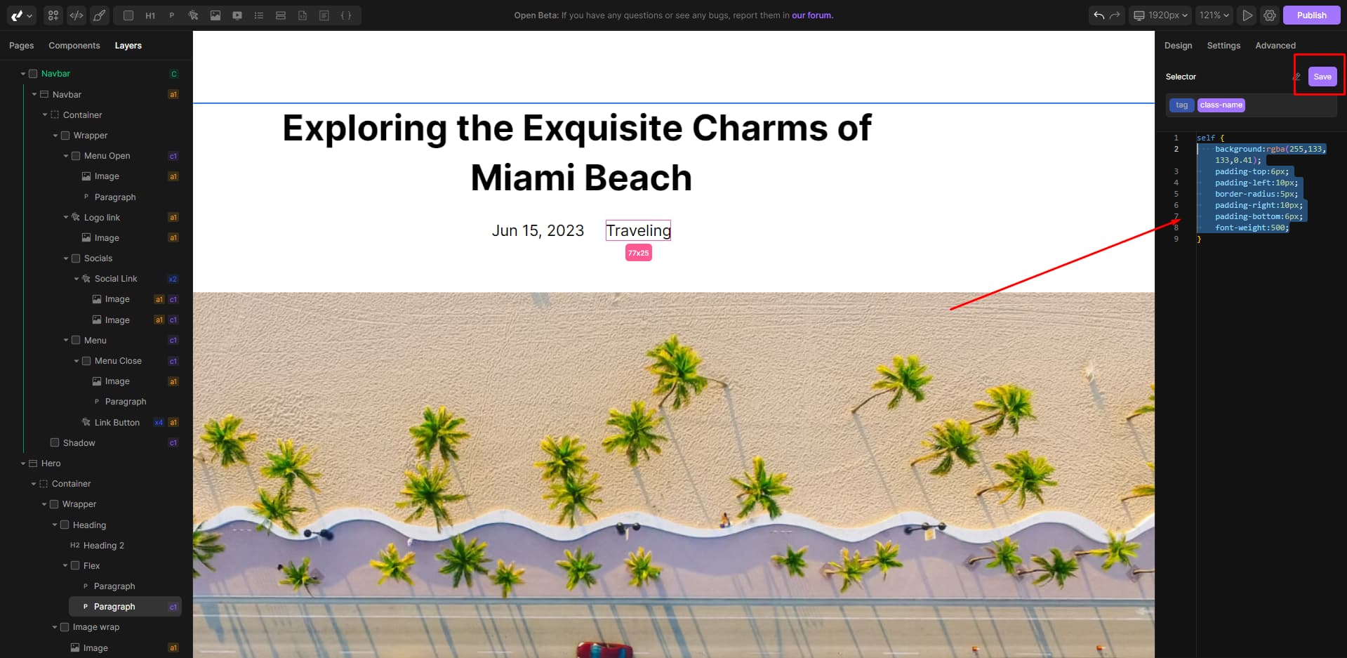

- Just paste your code there (and don’t forget to hit the save button):
