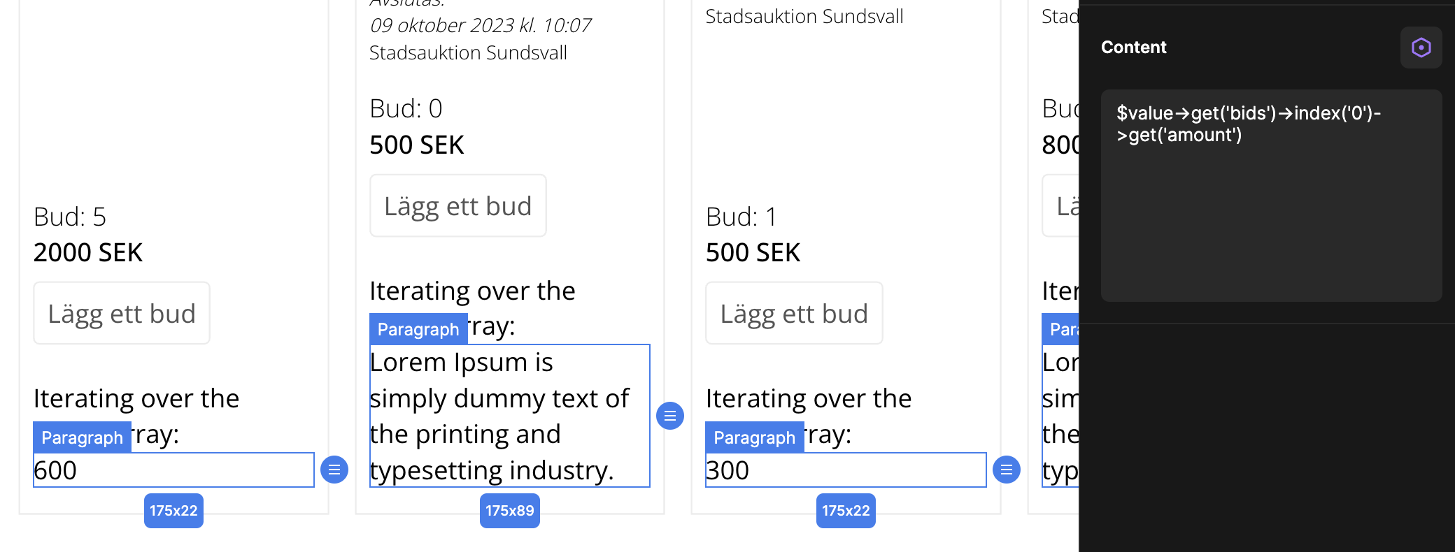

@MixxMaster
You can do something like this

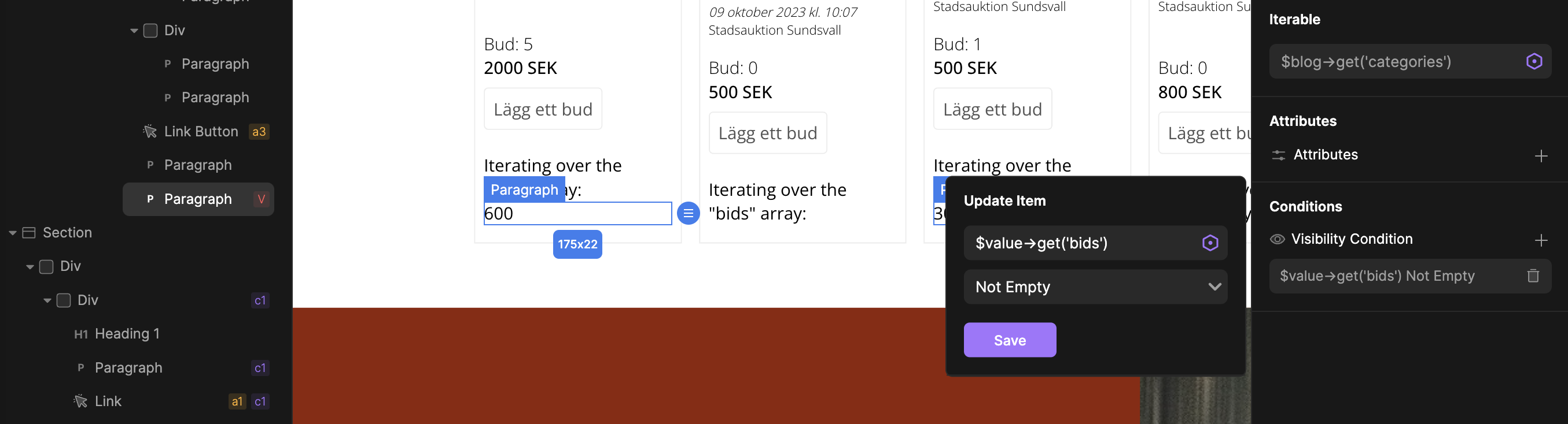

You can also use Conditions to hide the paragraph if there is no bids available, I can help with that if needed.
@MixxMaster
Like this
@MixxMaster
You can duplicate the paragraph and put another content and reverse the Condition to EMPTY to show something else like text No bids yet or similar.
