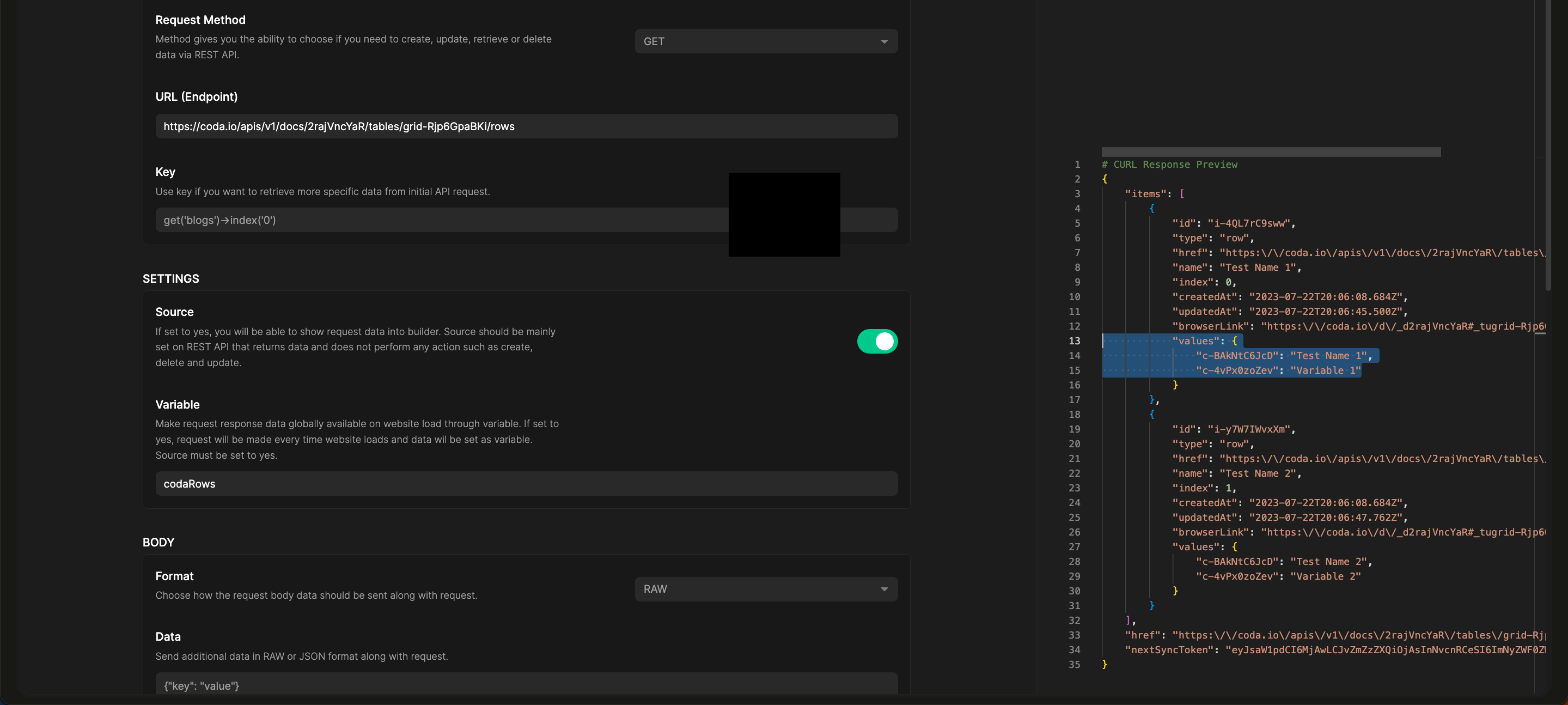

The Coda API will allow me to pull in a table, separated by rows. Ultimately, my goal is to have each row on its own page, with the cell data from that row populating the fields on that page.
The actual cell data, though, is inside an object (‘values’) that’s nested inside the object for each row. The row data itself pulls in the rows nested under the object ‘items’:

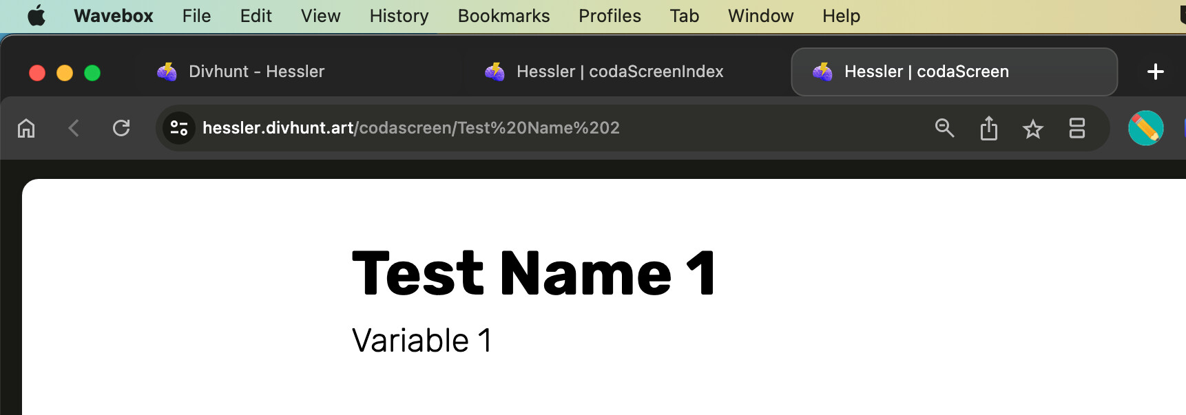

But when I try to do it for the individual pages, it always shows the ‘values’ data for the first row. I’ve checked, and the slug is updating appropriately (i.e. the slug for “Test Name 2” is the right one for that page), but the data on the page itself is still the data from “Test Name 1”.

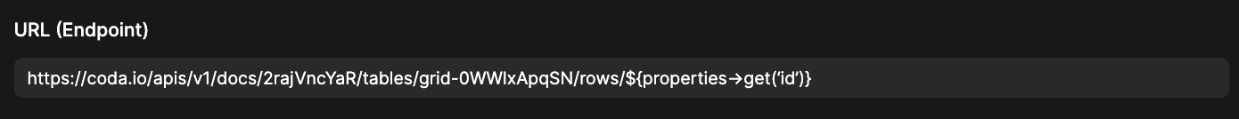

Okay, I set up two different GET requests, one that lists the rows in the table, and one that gets only the first row using that row’s id as part of the endpoint. What’s next?

Now create new page (or use existing one) and right click on that page > set source > and then choose that GET request you made

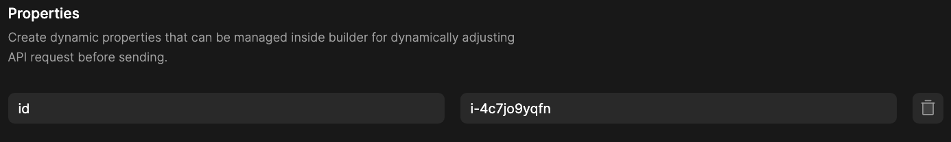

And for the last step for this to work, you need to configure proper route for page, in this case, we are using dynamic property id, so you need to configure route to be for example /something/:id
When source is configured, all the data for that single page are accessible using variable modal system under page > data keys.

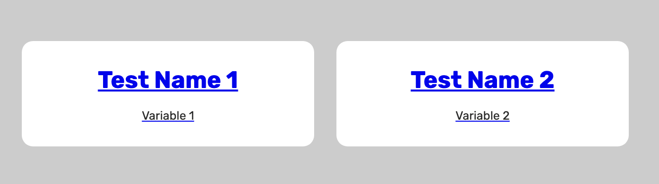

I was able to set up the index page using the data from the GetAll API request, and then I set up the singular page using the data from the GetOne API request. I ran into an issue when I tried to link the two. The method of clicking on “Page” > “name of the singular page” didn’t work, BUT I was able to direct it to a link instead. I entered the URL for the singular page, and adding variable /${value->get(‘id’)} worked to direct it to the right spot.

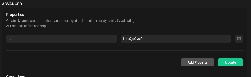

You can still link to page in Settings tab, and then go to Advanced tab and you will see the that same ID property waiting for you to fill up with value (also you will have variable modal) so it’s easier for you.
