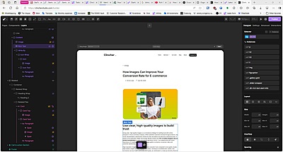

I have an urgent issue with collections (blog), where rich text loops twice for no reason (at least not due to any options in the builder).
I hope this recording explains it:
This only started happening when I wanted to publish the second blog article. For the first one, content looped only in the builder, not on the live site. However, as soon as I published the second article, both blog posts looped.

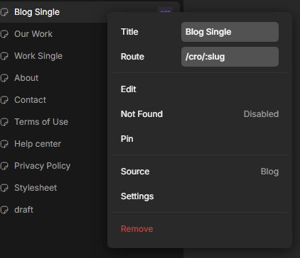

I can’t tell from your video, but are you applying a source to the whole page (as per DivHunt’s CMS instructional video) but then calling the CMS a second time by connecting a source to the ‘Content’ Div?
I’m using Codify template, didn’t change predefined settings.
Source is applied to the whole page:

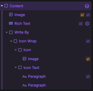

Content Div is also connected:
That was the issue!
I’ve disconnected it from the source.
