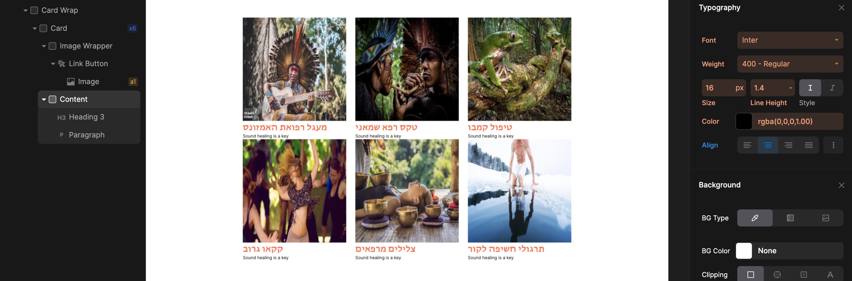

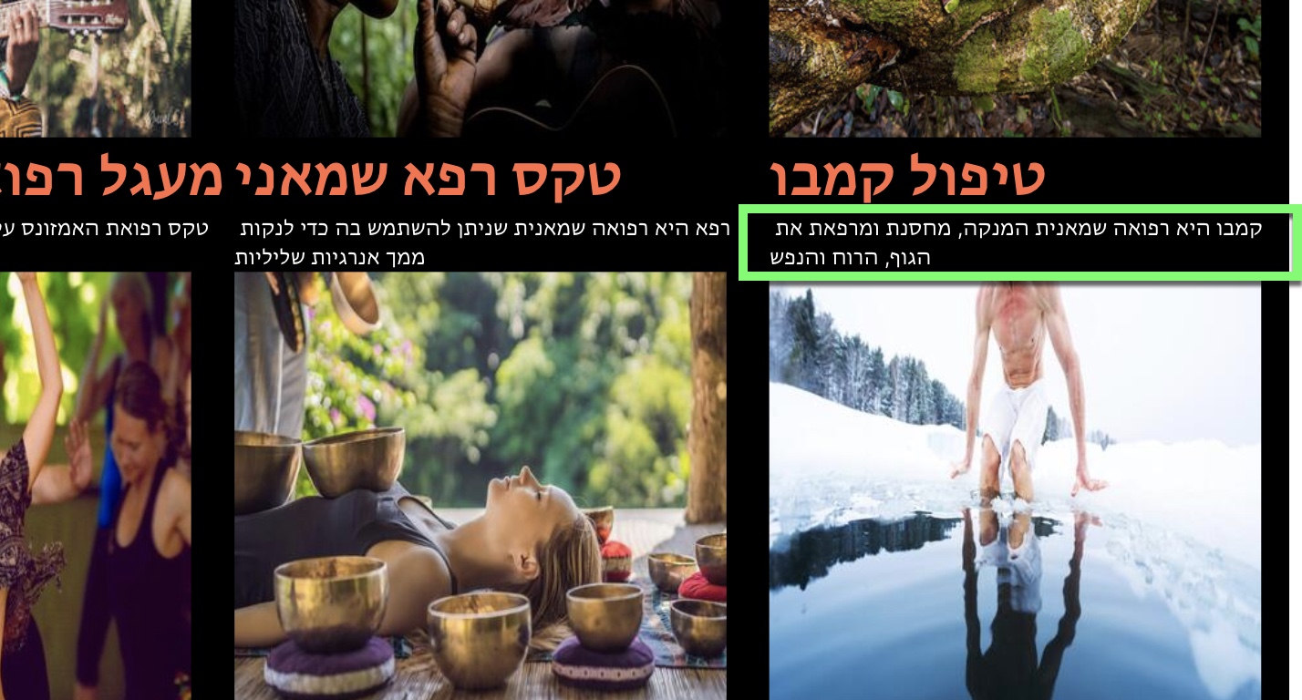

I am configuring a grid section of 6 photos and text heading under the photos.
I need to put the text in the center of the image.
There are 2 options that I know.
  1. To use the padding on the div’s content.
  2. To put a relative position on the content div and to move it to the center.
Is there a better way to center the text automatically?
Which display is also better to put the wrapper on?

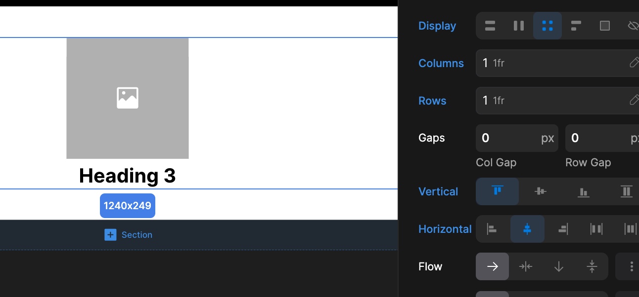

When I use the flex and grid display on the wrapper it only centers
the text under the photo in the middle of the div.
I need to place the heading and the paragraph in the middle like the photo

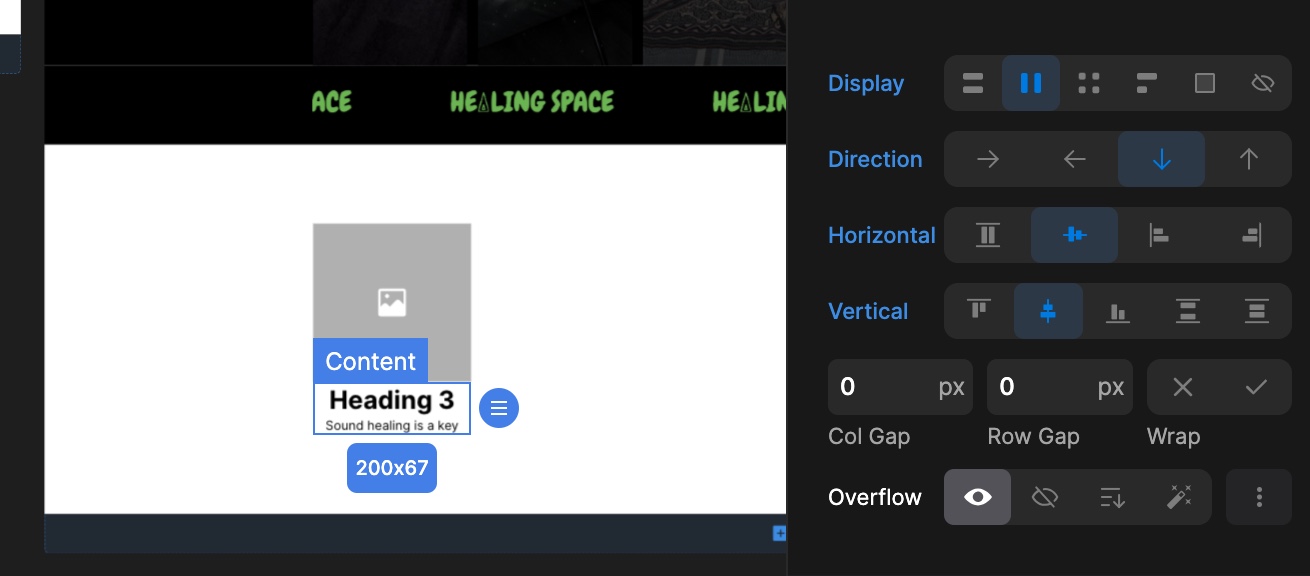

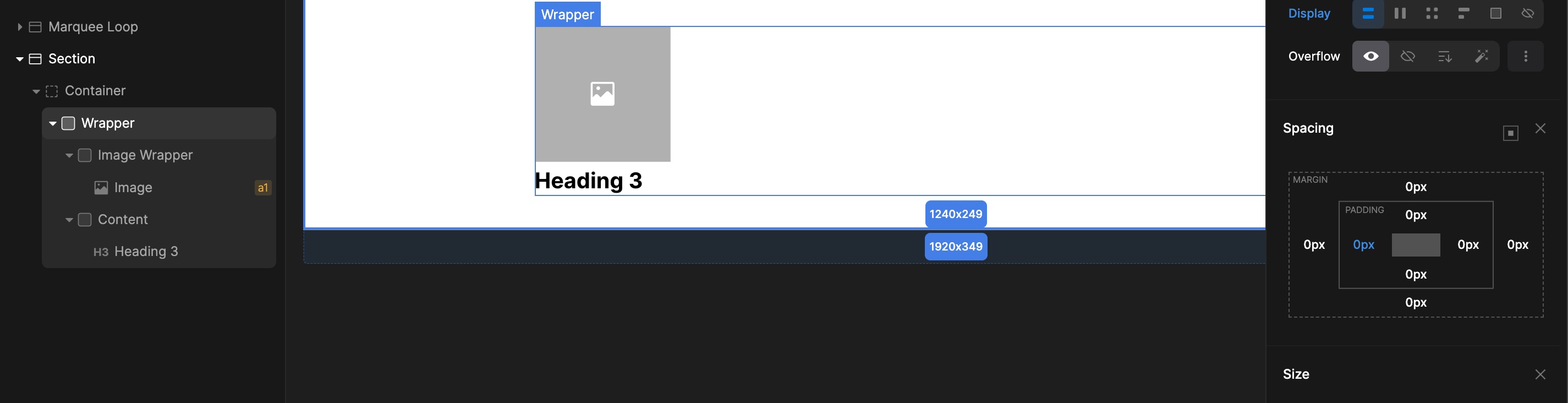

I discovered that it works when I put the content div on display flex, direction column, vertical center, and horizontal center.

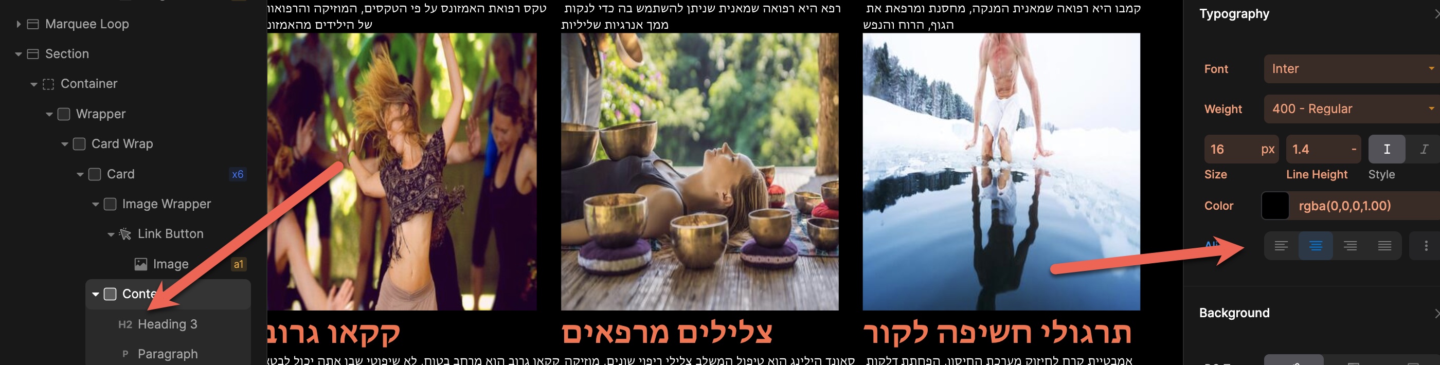

Hey @Stolichnaya I’m glad to see that you like to experiment with builder. When comes to text alignment there is one handy option for that, in the typography panel you can find align options for text:

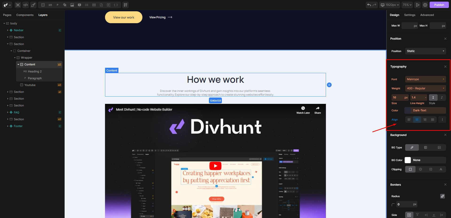

And one advice, if you want to center multiple text elements like I did here (I have my heading and paragraph centered) you just need to set this alignment option to the parent of your text tags, that way you will set all of your text tags inside of your parent to be centered, just like I did in this example:

Why the align option doesn’t work on my parent content?
I put it on my div: content and it doesn’t work.
If your text tags (H3 and paragraph) have align option set to them this method with parent wont work.
I have also tried to change it to Heading 4 and 2 and it the align on the div didn’t work.

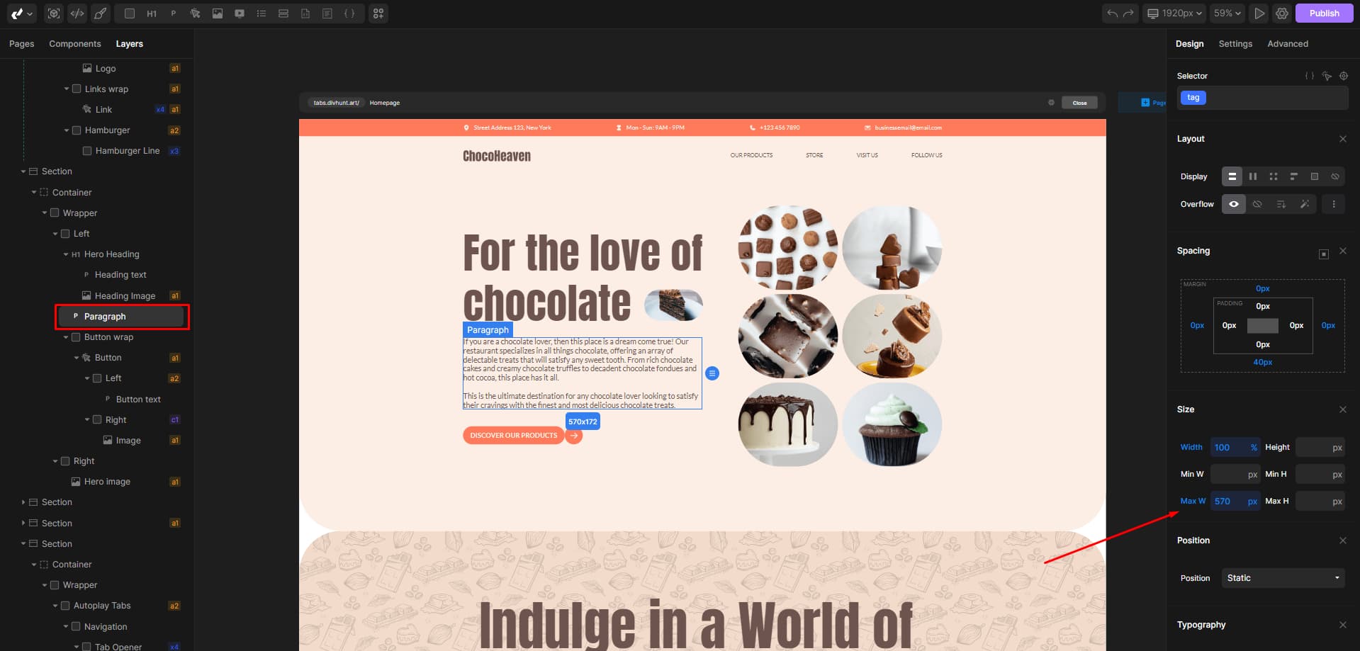

If this centering method doesnt work just set those align options directly to the text tags. And for the width of the text, best option is to set maximum width to your text tag, you can find that option here:
In this case you can set max-width: 200px or something on your paragraph.
