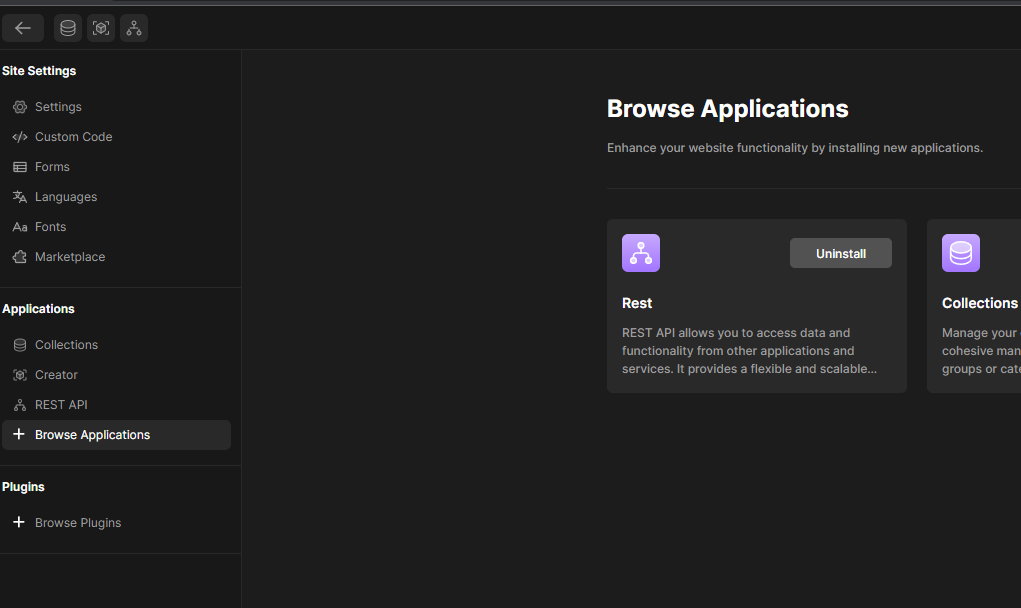

1. Install REST API on your project

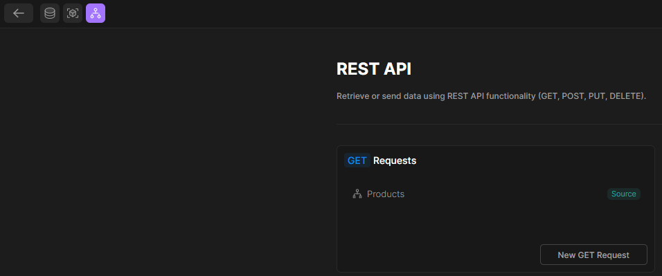

2. Open application from top navbar and create GET request
3. Call medium REST API endpoint

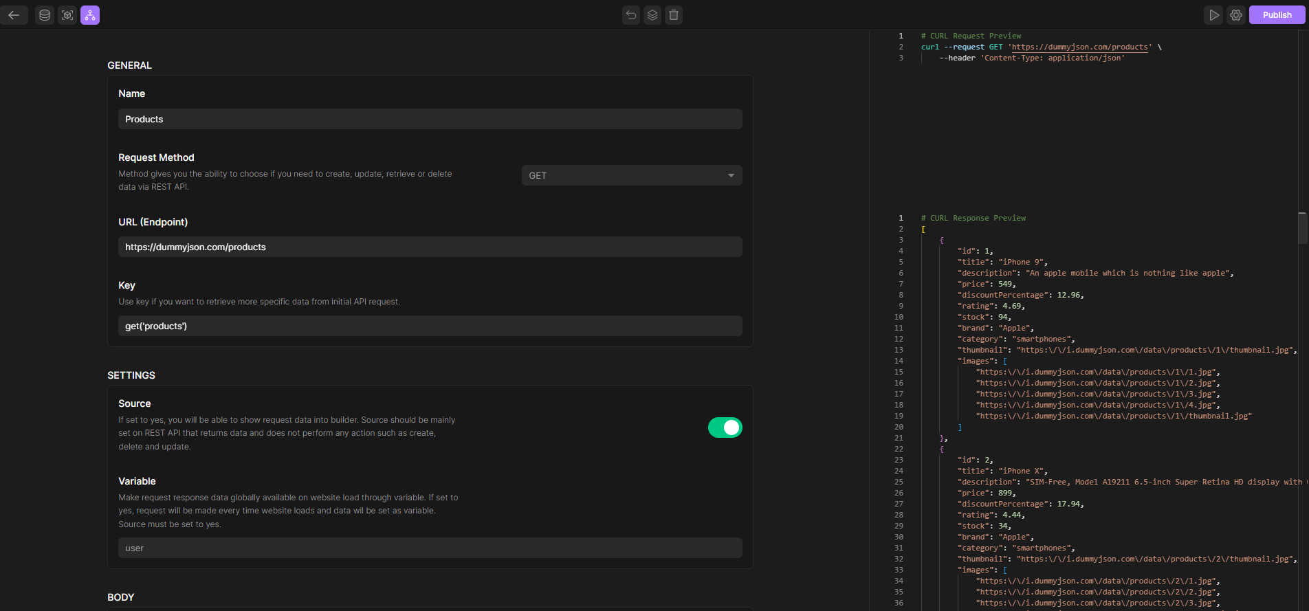

4. In advanced tab in builder, when you select some element such as blog cards, you will see REST API sources
and from there, it works very similar to regular CMS & Airtable integration which you can checkout here.
