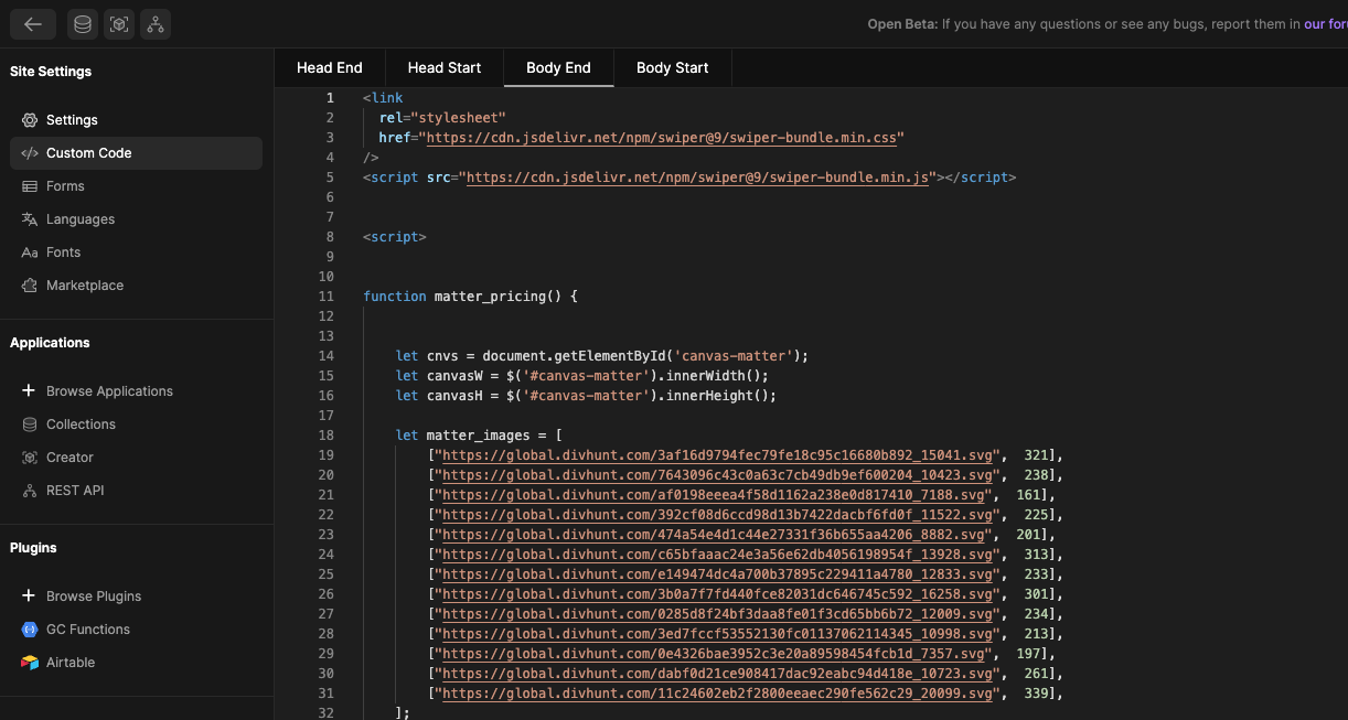

Most easiest way, if you don’t need advanced file organization or similar, is custom code on project level.
So go into admin panel > Custom code, and paste that modified snippet into “Body End” for example.
That should do the trick. Let me know if this works for you.

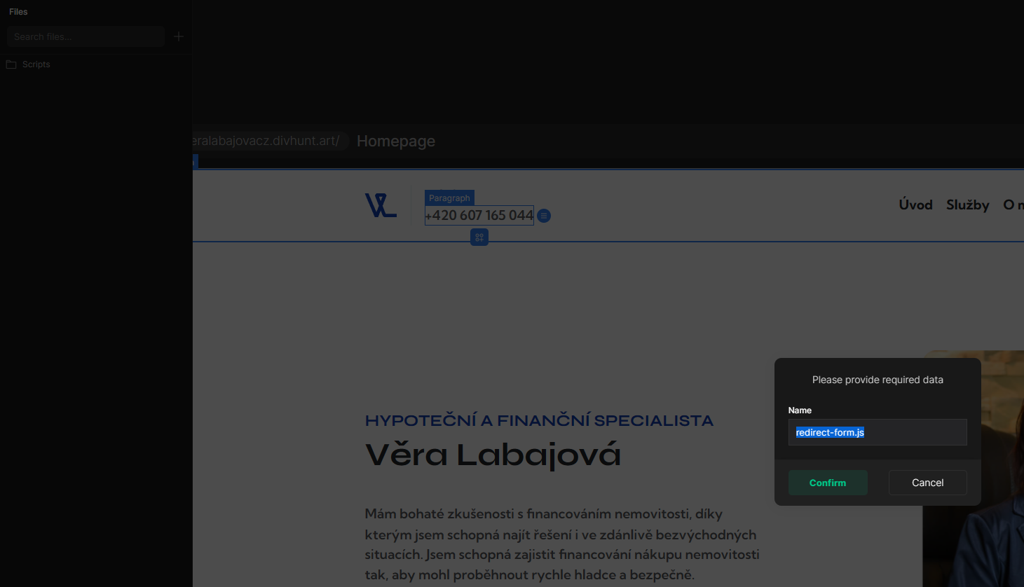

Yeap, that’s same as Webflow approach. I was just curious if there is option to create custom code via Files and than bind the code within the form.
Yes, feel free to create file, name it as you like, make sure you select “onReady” event, (it’s the default) and then paste the code.
If you right-click on file, you can see more events, like
onReady - Code will be executed only on website load
onPageReady - Code will be executed every time visitor changes page
