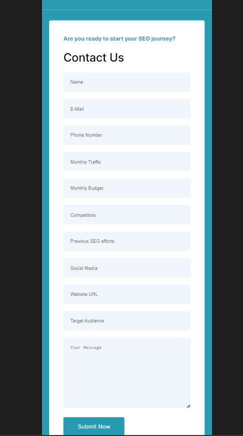

Hello I made this contact form on my but unfortunately it is not working. I configured it to slack just like the video. Could you take a look?

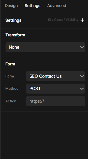

And inside builder - on the main FORM tag, have you configured which form to tie with? Under Settings tab > Form settings?
Yes, test the form now.
doesnt work from my phone. it seems that the button is unpressable
Hey Chris,
I fixed the form. Issue was that you have been using “Link Button” instead of regular button for forms.
Regular button for form can be found when you hover form tag in top bar:
Thank you very much
