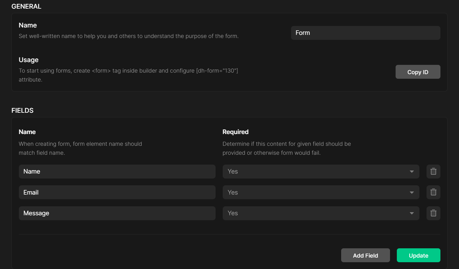

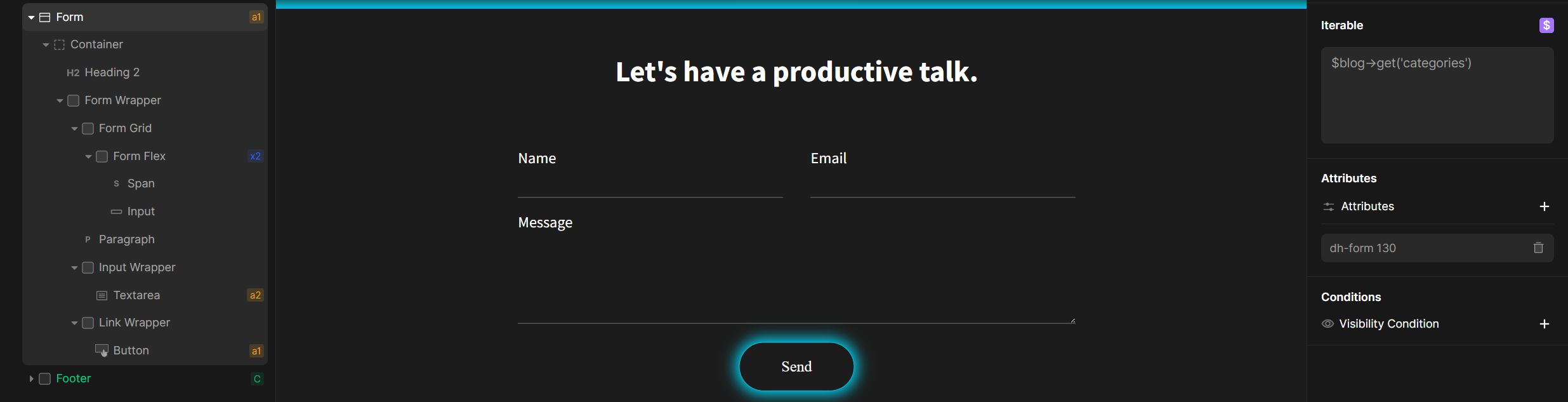

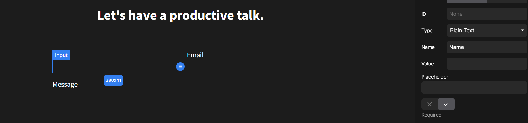

Form set up as instructed on forum but is not working
Please guide me ![]()
Seems fine, could you share link so I can debug?

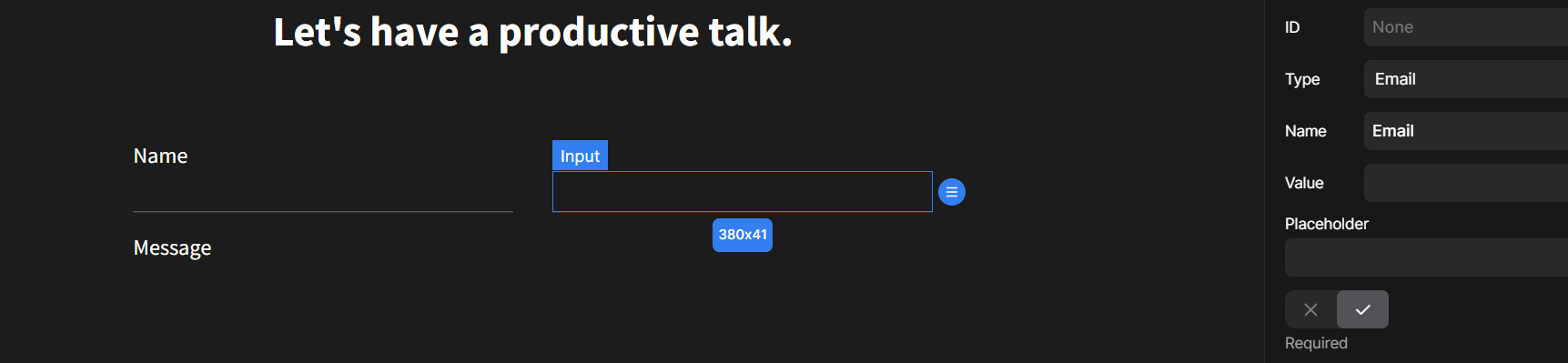

The “Form” element is actually not form but section ![]()
You need to change it to form tag.
Click on that “form” labeled section
Then right click here to change it to actual form
Ohh, I totaly missed that LOL
, Thanks allot ![]()
You’re welcome ![]()
I tested the form on your website and seems to be working properly, you should see the submission in your admin panel.
Yes is working , 1 more thing
how I can see the actual form ?
And I set up an email address to send the form too but is not working
When you enter the form, you will see the “Submissions” tab to enter and see your submissions.

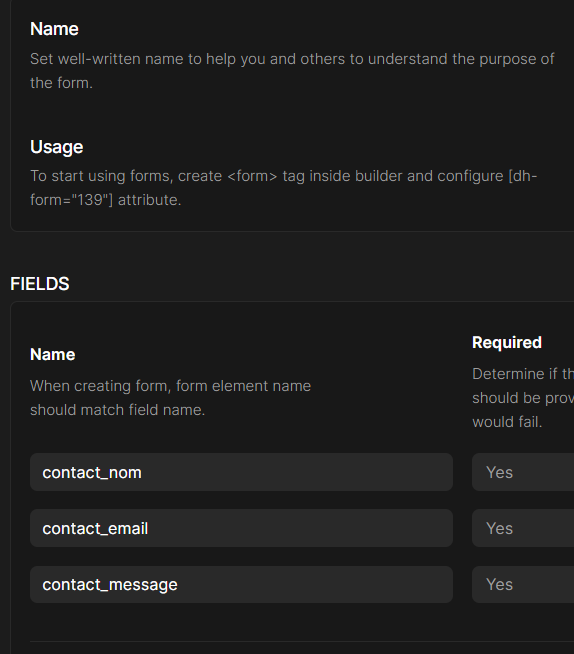

I got it. Form ID is the DH one
I would suggest using FIles system inside builder for better organization. Make sure that file is onReady type so it get’s executed only once.

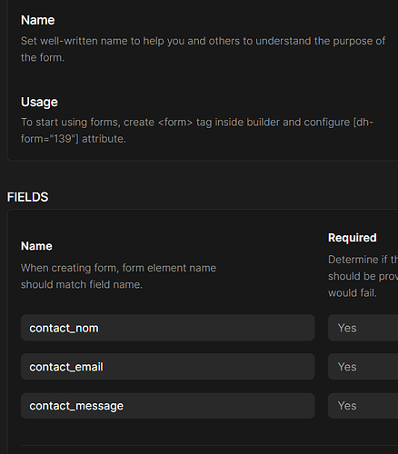

I believe it’s data.fields.contact_email, but do console.log(data) to see what object contains first.
for the record, it is data.form.data.form_email
Documentation will solve this issue, hopefully next month, but as for now, your response will have to do for others, so thanks for that ![]()
