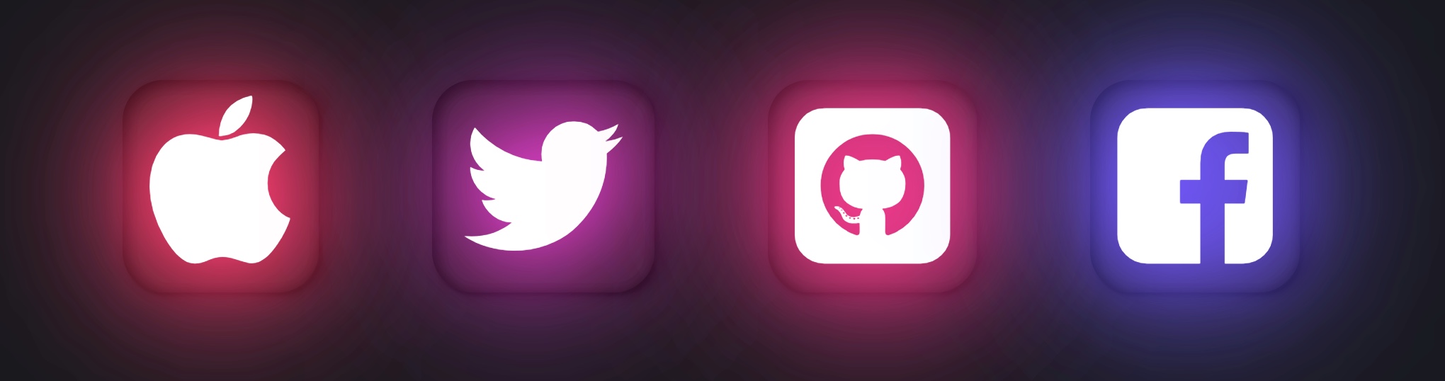

On the Glow effect Div, there is position Absolute:
You wanted to put the red square under the photo.
Why did you use a simple transform 50px vertical instead of using the position feature?
