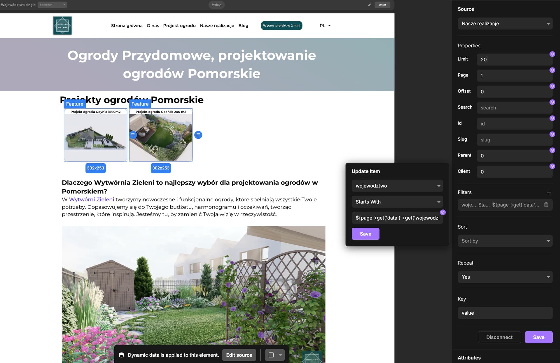

I use filter option as you can see on the screen

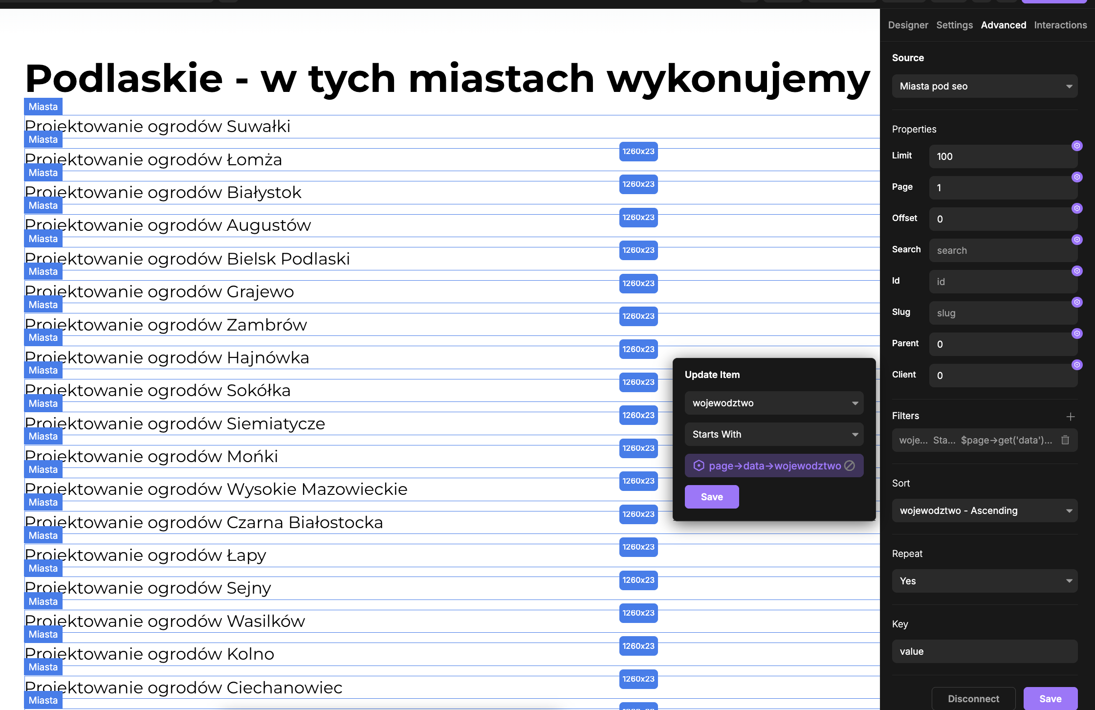

Voivodeship single page - example Projektowanie ogrodów Opolskie
(use filter from my gallery on the top and filter the cities cms on the bottom of the page)

I have city-specific pages for the locations where we offer our services (a few hundred cities). Each city is tagged with its corresponding province (voivodeship).
I also have province pages (16 total).
For the province pages, I’ve applied a filter to show only the cities that belong to the same province (i.e., their province tag matches the page’s province name).
For the city pages, I’ve done something similar – the filter ensures that only other cities from the same province are displayed on that city’s page.
I used the filtering option like in the image you provided. Is this what you were referring to? Or is your issue about applying different filters for subpages that share the same component? Let me know, and I can explain further. :blush:
