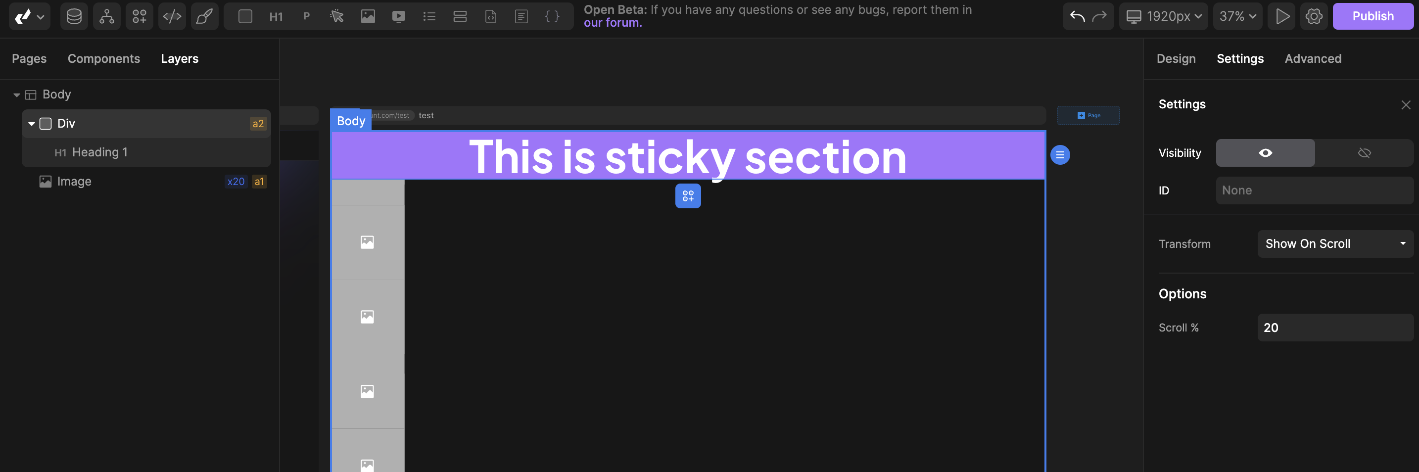

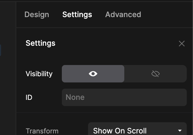

I’ve added option for pixels too.
If you have installed plugin, reinstall it (uninstall then install) to get latest updates.
So you can choose pixels or percent.
I can add more options to plugin if needed, like option to close sticky on click or similar.

Is there anyway to control the speed of the object set to show on scroll? The transition is very abrupt and I noticed that show on scroll - collapses the section - if i set the pixels to too small a value - the section beneath appear before the scroll reaches the set pixel.
Perhaps a “fade in” on scroll would be a better implementation.
