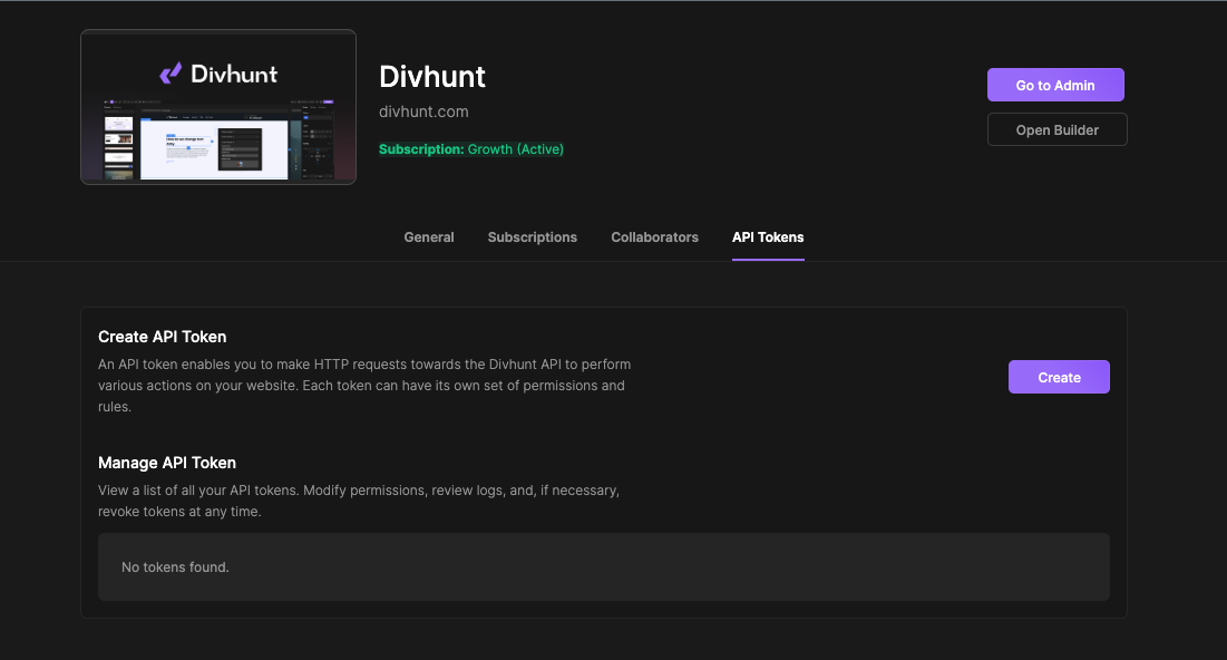

  1. Go to Divhunt Dashboard
  2. Navigate to your project settings, then find the tab API Tokens

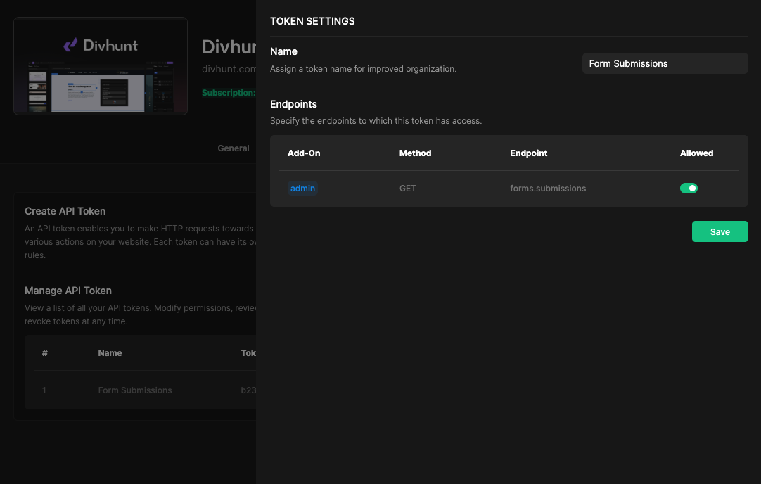

  3. Create token, name it like “Form Submissions”
  4. Go to token settings, and allow the GET endpoint forms.submission

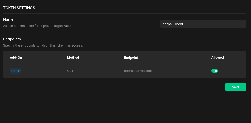

I’ve added the permissions and such:
Not sure if I’m missing anything.
@Serpa
Authorization without “Bearer” just the token.
@dejan
Thanks, I removed the Bearer and also added an s to the end of submission :slight_smile:

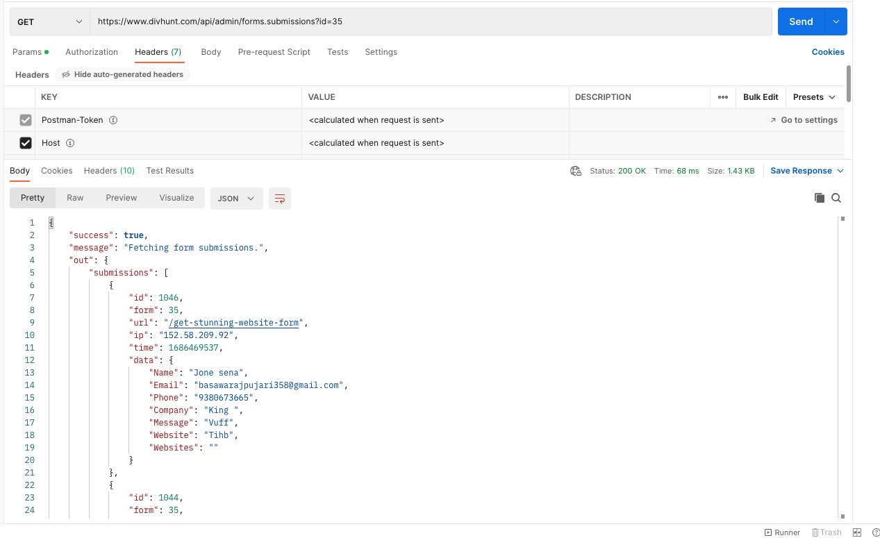

End result:
curl -H "Authorization: XXX-7" "https://xxx.divhunt.art/api/admin/forms.submissions?id=459"
