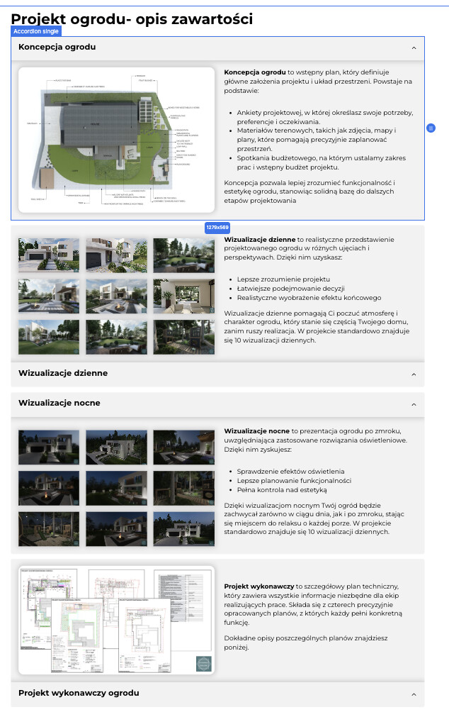

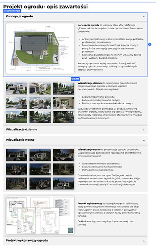

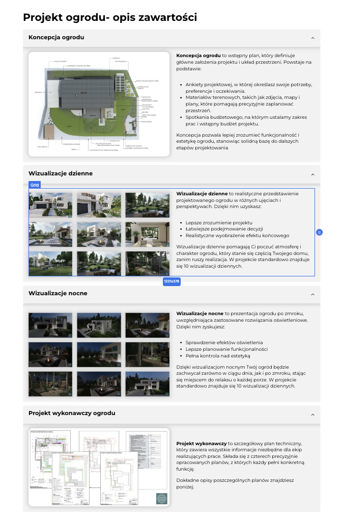

Hello! How can I style odd or even childs in accordion?

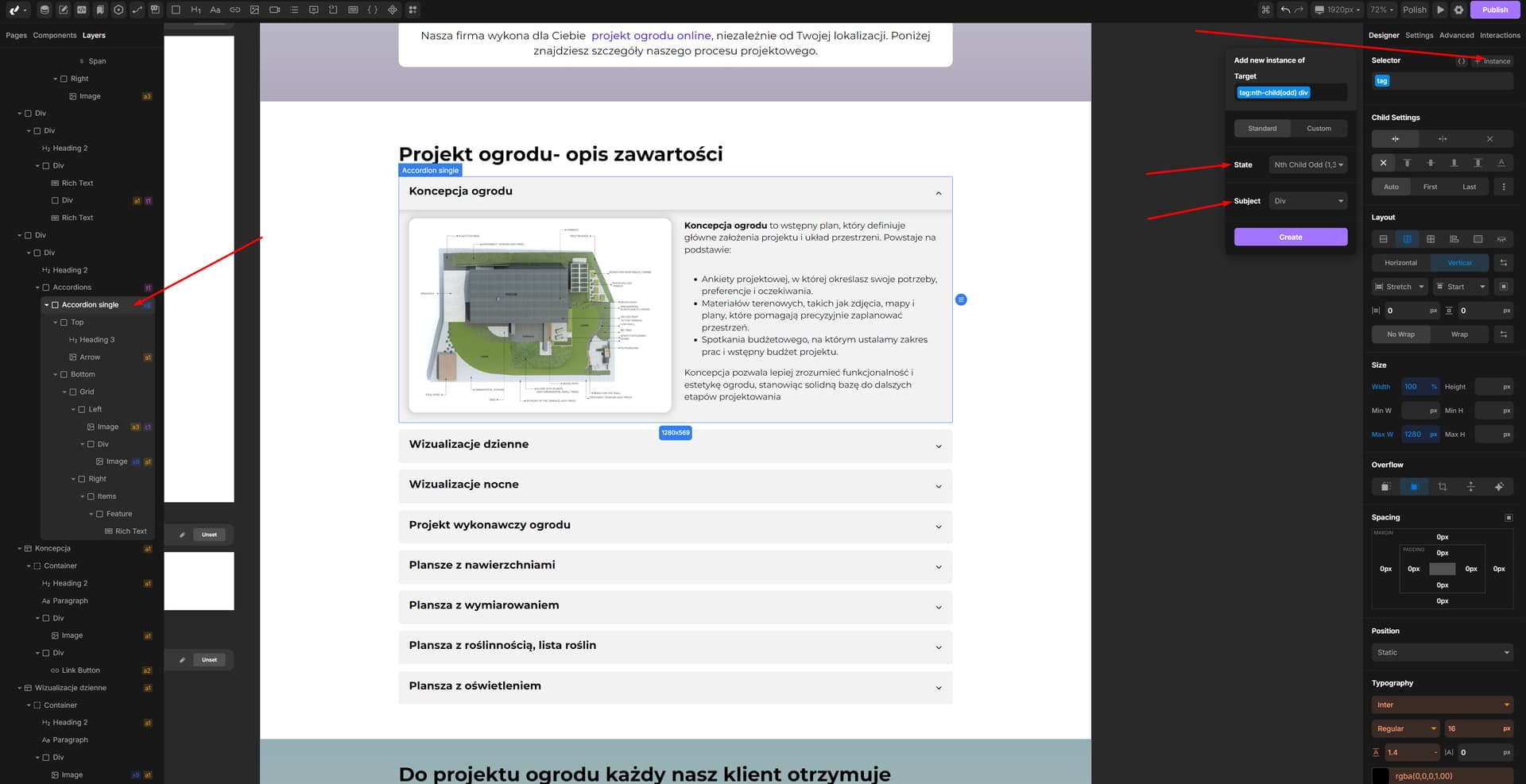

Need to make my grid change one by one(even/odd). So It can look good.
Tried do add instance to the grid but not working

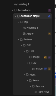

I can add instance do the accordion loop but this is not what I wanted to achieve.(change position of top-bottom)
Watched all the instance tutorial but cant figure out hot to style inside looped element?

From my understanding, styling elements inside looped elements is still very limited. Are you able to assign a class to the grid and target that through an instance on the main looped element?
Hey, here’s the setup:
If you don’t want to style all the divs, you can add a class to the specific child element you want to target. Then, in the Subject field, select that class.
If some styles don’t apply, try right-clicking and selecting Set as Important.
