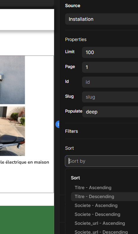

I would like to select dates to sort my articles but I see only this :
I might need to add support for that, will check it later on today.
@dejan , I’m interested having the capability to choose sort, especially on dates
Please share you domain name again and also let me know when Strapi is live so I can add sort by date.
@dejan
temlab.divhunt.art
Strapi live now
@dejan : probably that the sorting capability should also be available when defining an iterator
Try now. Also I have to go, but will back on approx 4h, so I will check your response later.
@dejan It works like a charm for most of my usecases.

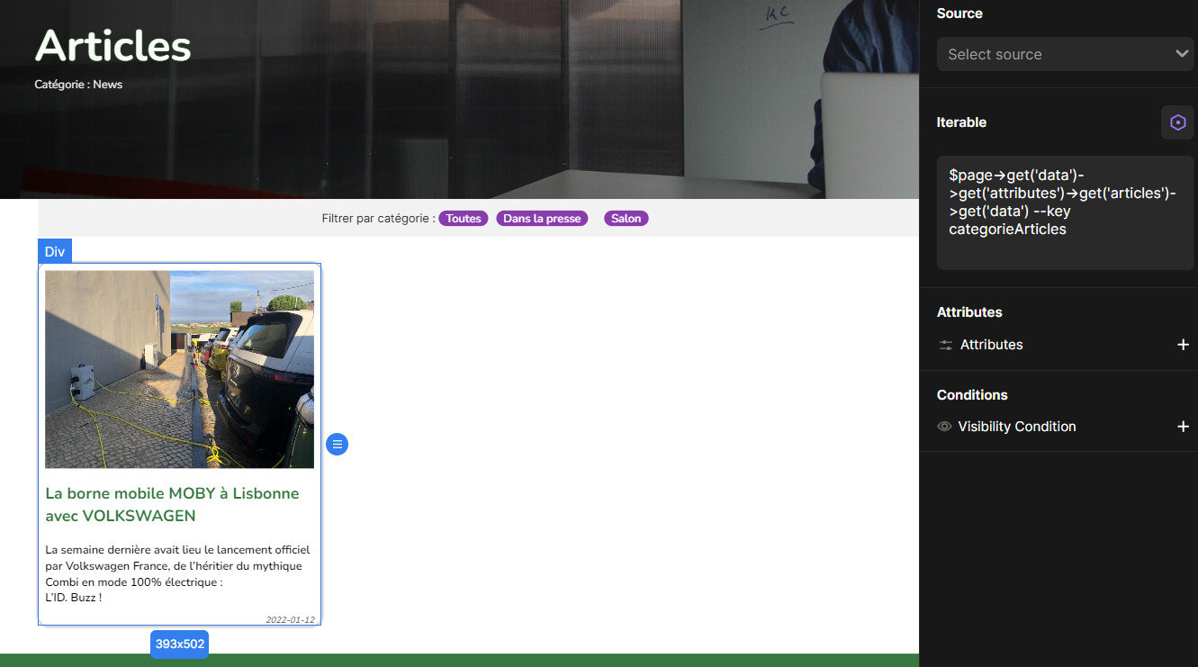

However, I would love to define the sort for iterables.
Example: in the article category, I’m displaying all articles using an iterable to navigate the relationship. I would love to get articles sorted with most recent article first and probably latest 10 articles only
and to go even further, even if I don’t have this need for now, but filtering/pagination would be wonderful
ping @dejan for the sort, number of rows, filter on iterable. Some news on your plan ?
Not sure about this one, it’s bit limited for sources on page. You can call another source inside page to get list of what you need with proper sorting for now.
Humm I see. However, it means getting another call for data which is already in the data structure.
If I understand correctly, it is a better approach to have several sources defined than only one with a a big data structure in response. It could potentially have a better response time.
Correct?
