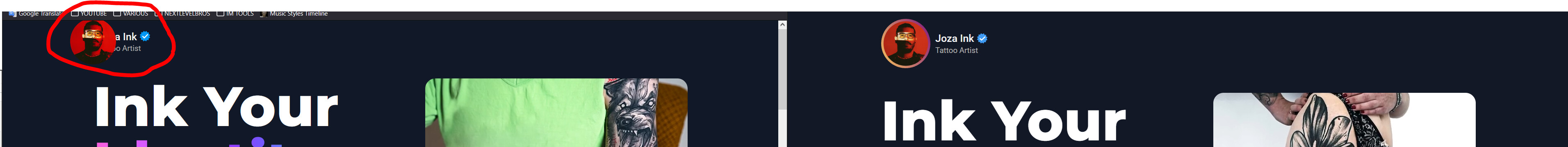

I noticed that an element on my website which looks perfectly fine on Chrome looks janky when viewed on Firefox.
I am really not sure what is causing this, can someone give me some insight as to why this is happening and what could be done to fix it? I would really appreciate some help!
Screenshot, on the left is Firefox, on the right is Chrome:
Site Link: https://joza-ink.divhunt.us/builder
The issue is at the top left of the page.

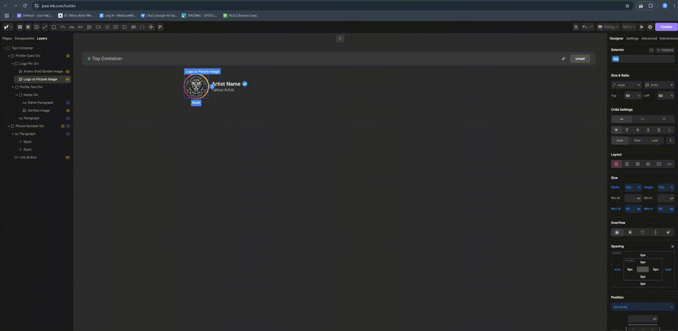

It’s been a while we spoke about this, but I tried what you suggested and it does not seem to give the desired result.
Here is how it looks when I put it as position static:
