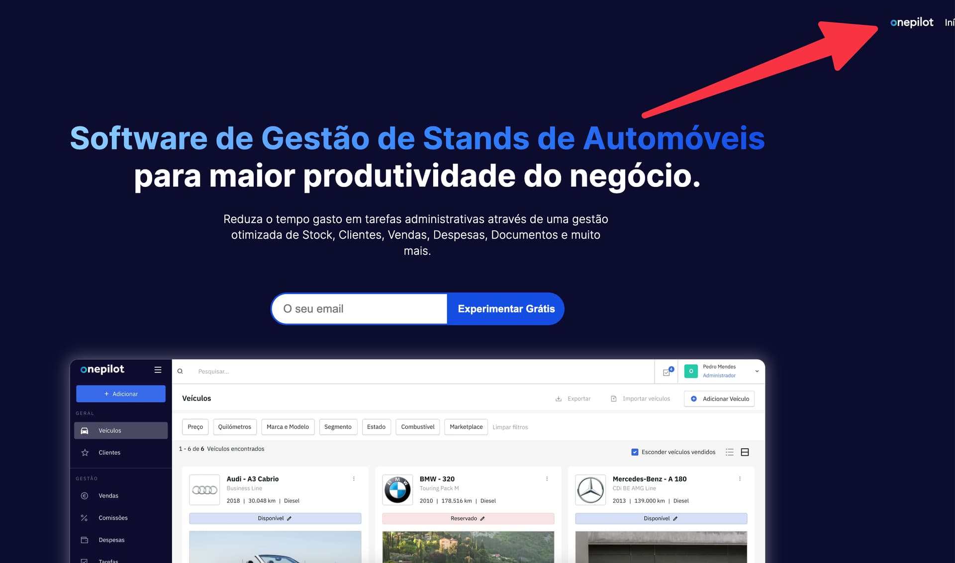

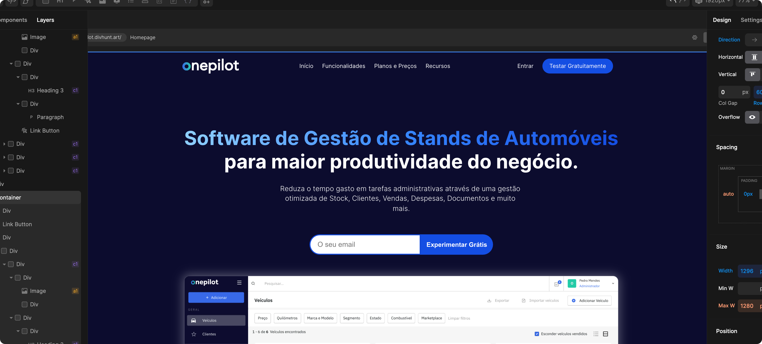

As you can see on the images attached, in the builder the navbar is correct but then on the preview it goes out from where it should be.

What’s your domain name?
Seems you have applied a swiper to the header.
@petrbilek is right, you have applied the transform Swiper on body tag I’ve removed it for you.
