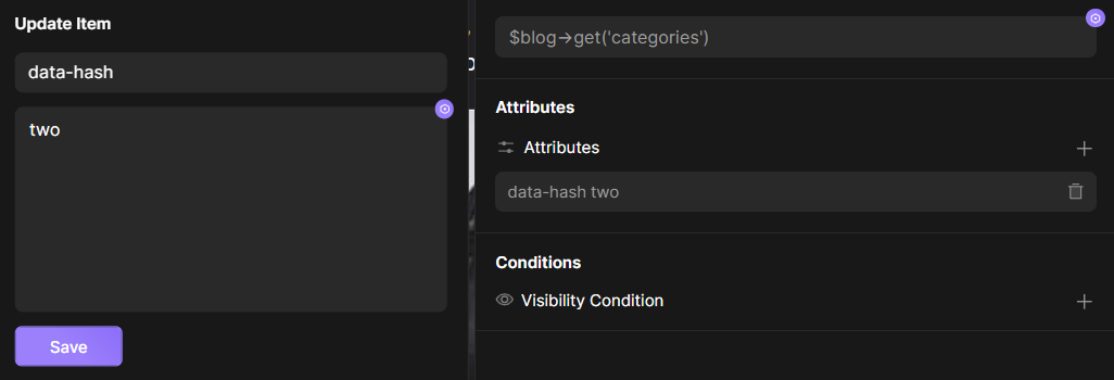

The strange thing that I am experiencing is that when I add these attributes, this causes the entire webpage to reload whenever a div with an attribute appears in the active slide.

Still stuck on this… adding data-hash="something" to a slide in my carousel causes the page to reload when that slide comes into view, not sure why that is happening - the page is not supposed to reload.

I guess owl carousel when you go to slide with ‘data-hash’ attribute, pushes /#hash to url, and that causes are system to refresh. I see you did some workaround without those hashes, are you happy with that now, or do we need to figure out a solution still?
