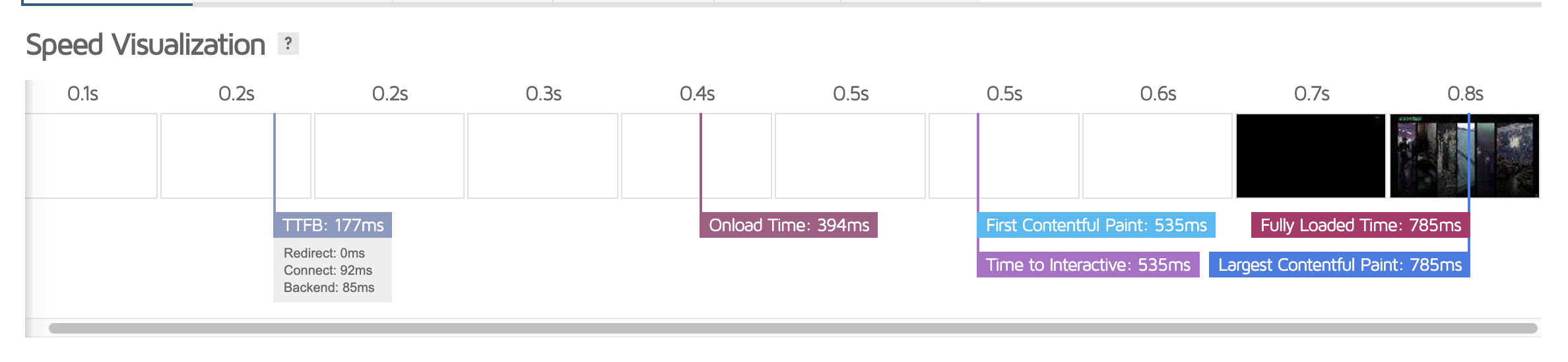

GTmetrix - it will realistaclly show you how fast your website is, and focus is on that.

Looks at GTMetrix and the waterfall. That will help you identify issues with your site loading.
