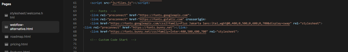

And fonts are working on my side, I’ve tested both Bunny and Google.
Can you give me your website url, so I can test it out?
Is something like this generated in your HTML?

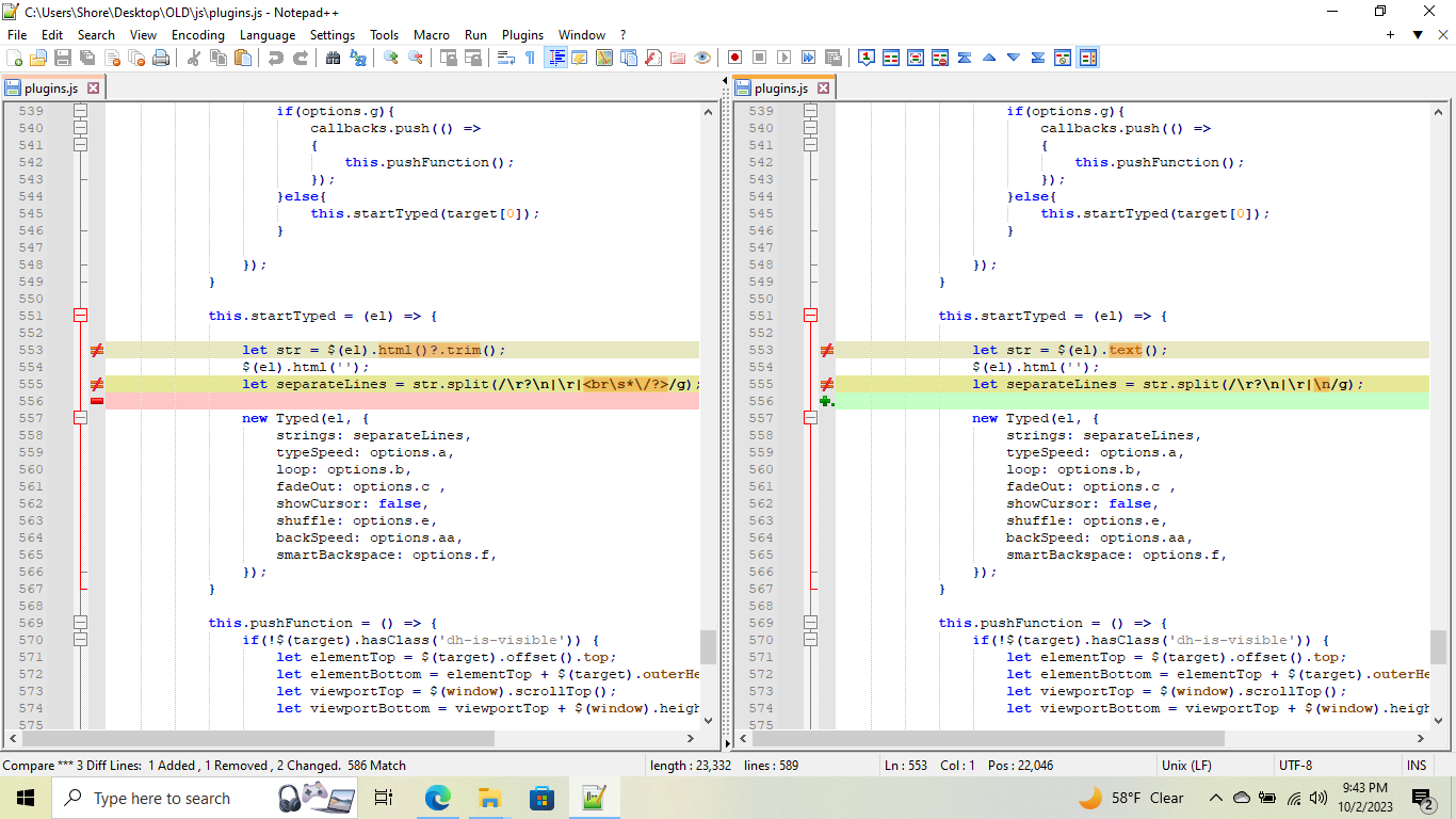

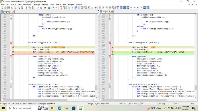

@Pakic - looks like there is a difference of code in typed.js between the exported code in alpha version, and exported code in beta version - see screenshot:
(Alpha version worked if I recall correctly) - I think line 555 is the problem since it’s not separating lines properly.
I did a fresh export and it seems to be working now - thank you @Pakic for your help!
