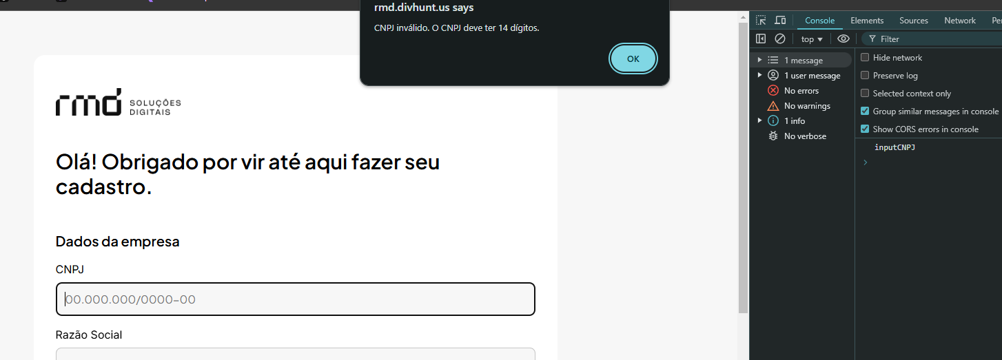

If I am watching correct website, code is being triggered on blur.
I put a console.log when this event happens and it is being triggered, you can see both in console and as an alert.
If something is not working, it is inside of that code, that API or something
Thank you @Pakic
It’s working :slight_smile:
