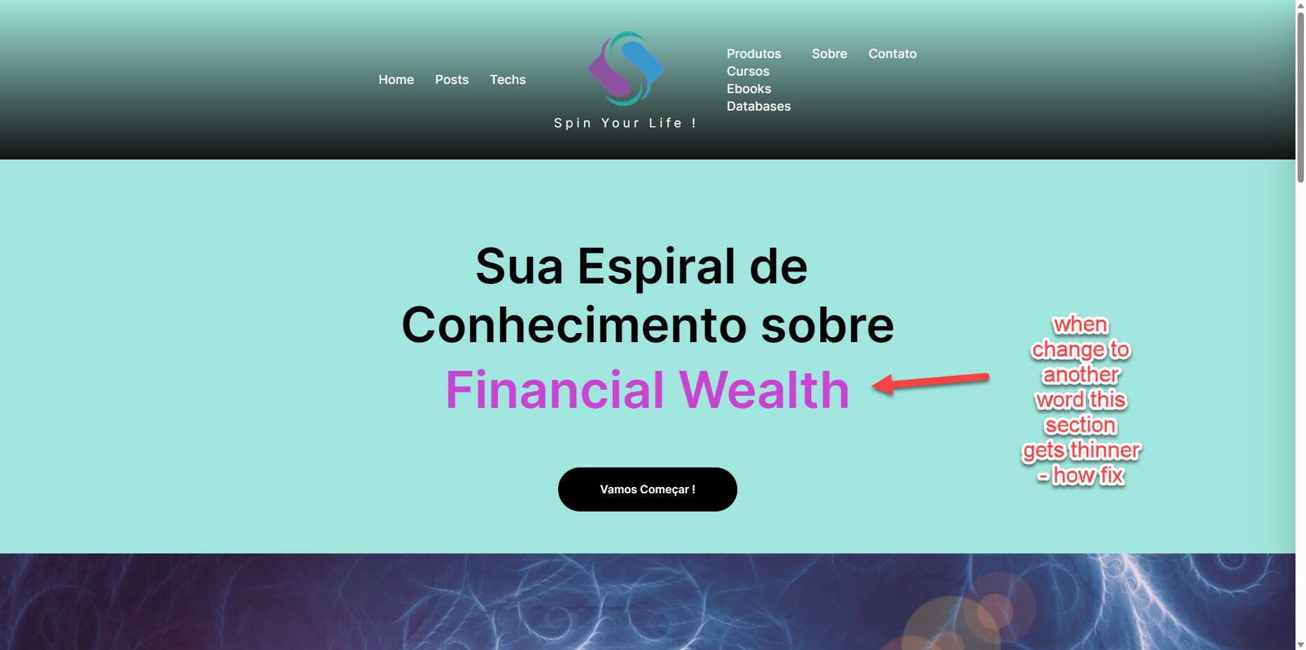

Hi I am new to divhunt and having some issues.
This is working but when the word disappear, before another word the screen section becomes thinner. All site below this section moves. Can you help me fix this?
Tks
Tks
Rogerio Chinen
can you try putting fixed height on tag where typed transform is applied? You can try putting around 60px height to your purple text in this case, and it should look better. Let me know if it worked
It worked. Thank you very much.
