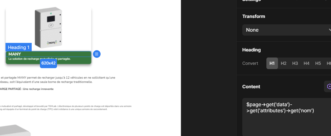

I’ve created the ProductDetail page with src Product & define route as /productdetail/:name
I’m using the variable Page->Data to display information

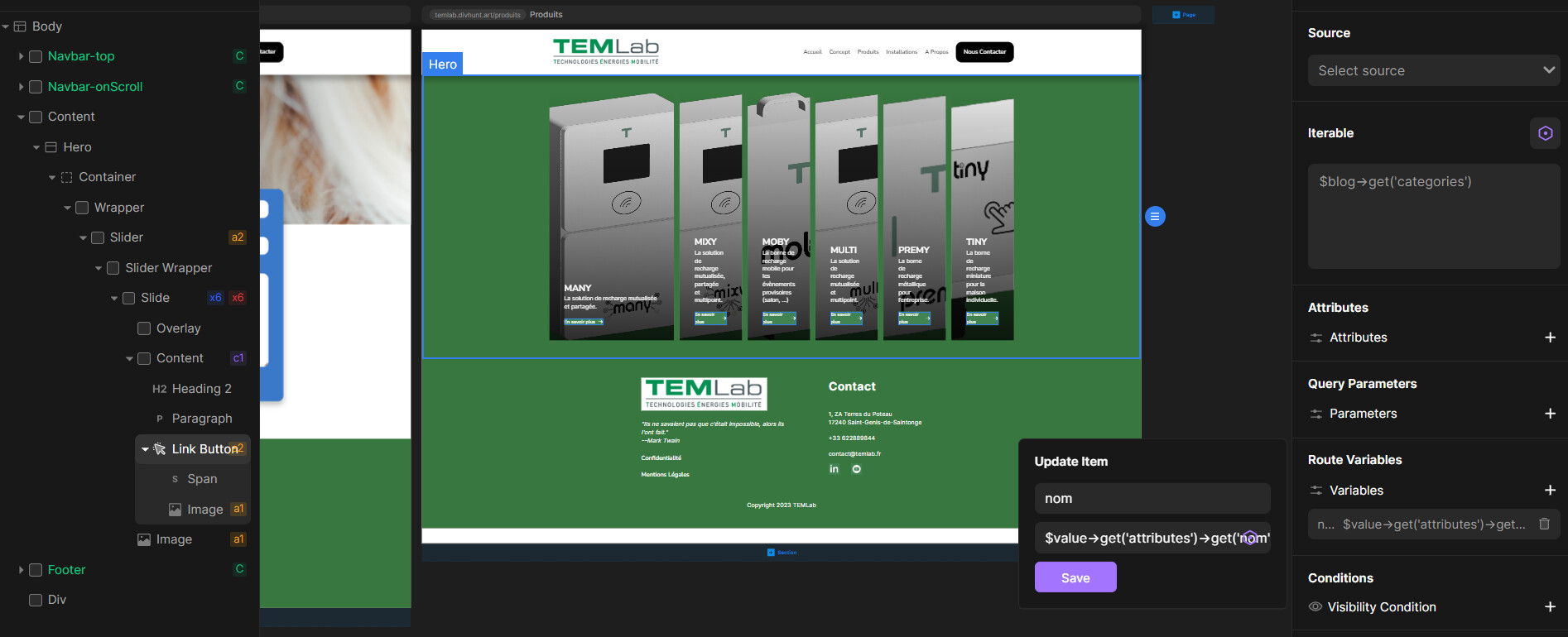

Can you try using route /productdetail/:slug or /productdetail/:id ?
In most systems, single pages are created by using either id or slug, so using anything else like name is not possible to for Strapi to find that record.
However, with Divhunt you can still use name in route, as long as you have id or slug included, for example:
