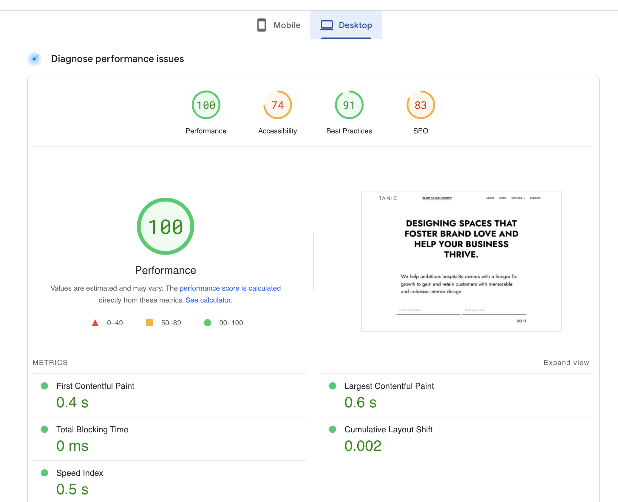

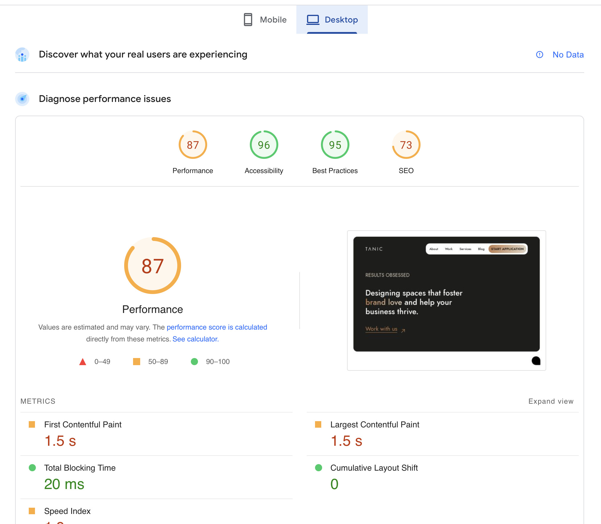

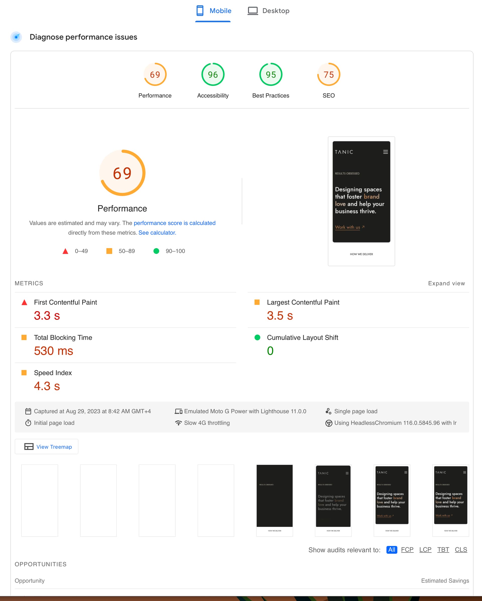

I decided to test Divhunt’s page speed against our current solution (WP) for a comparison. Surprisingly, the Divhunt test showed worse performance. Is this because my website isn’t yet “published” on a premium domain? Or is this how it performs generally?
Any thoughts? How can this be fixed? We are planning to switch from WP to improve our sitespeed and I am bit confused/concerned right now.

First you are using the animations on header, that’s proven fact that slows down the loading speed. If you remove that animation, it should increase the score a lot.
Also, I am guessing WP site is cached? While we don’t cache Divhunt websites atm, which could improve also speed a bunch. We will implement this in future.

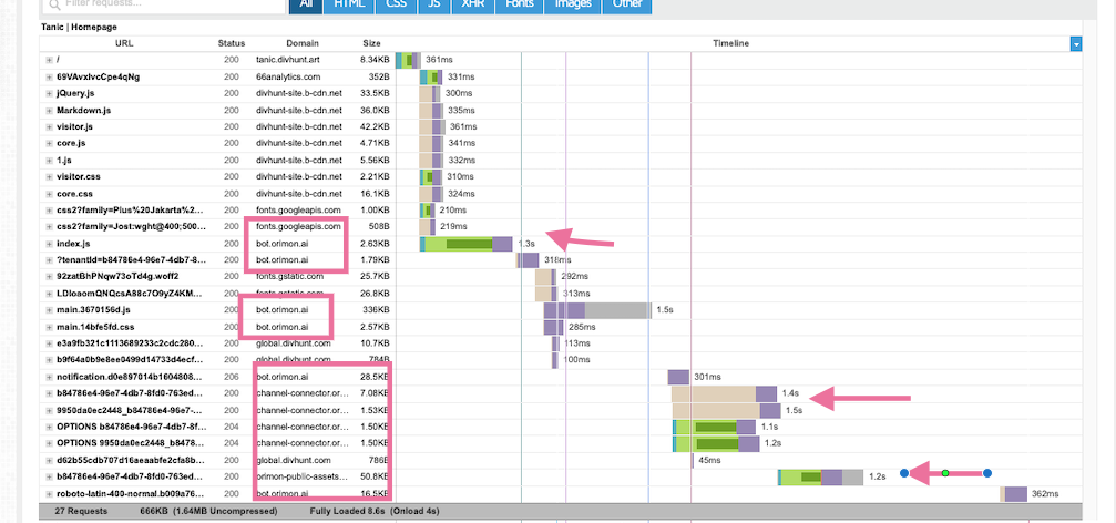

You can see only 21 requests were made, meaning that WP (or the cache plugin) is actually hiding most of page so it performs better on test results like this.
Another very important thing is to test website manually and not rely on the computer tests, because you can feel the speed in more natural way, and as I can see, website built in Divhunt, even that it’s not cached at all, loads faster, get’s refreshed faster.
Anyway, after my research, seems like your Wordpress site loading the Javascript functionality after you move your mouse for the first time, which results into faking the scores.
