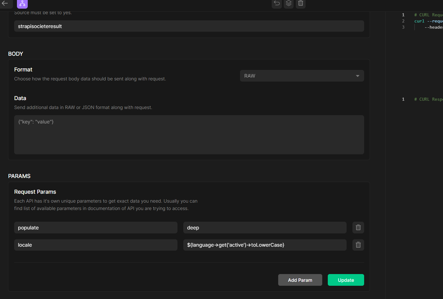

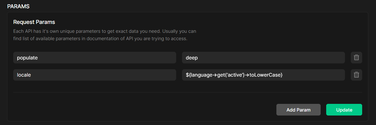

In your request, you’ve set Divhunt system language to be passed to Strapi, so it’s automatic.

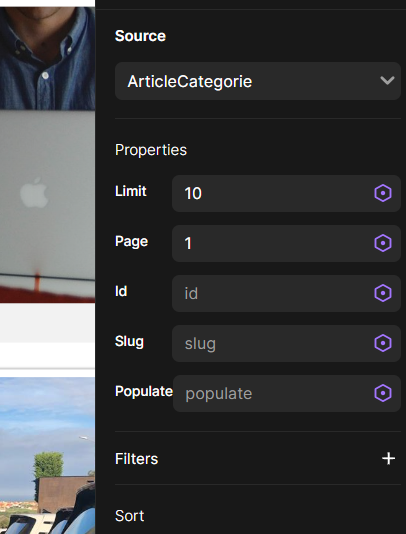

If you want manually to have property inside builder and choose language, then you need inside request to create new Dynamic Property called “locale” and then you’ll be able to manually pass locale.
