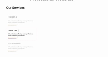

I’m trying to implement a feature where when a user clicks on a title, that title becomes larger (increased font size), while any previously selected title returns to normal size. This is similar to the tab-like behavior seen on Calendly’s features section.

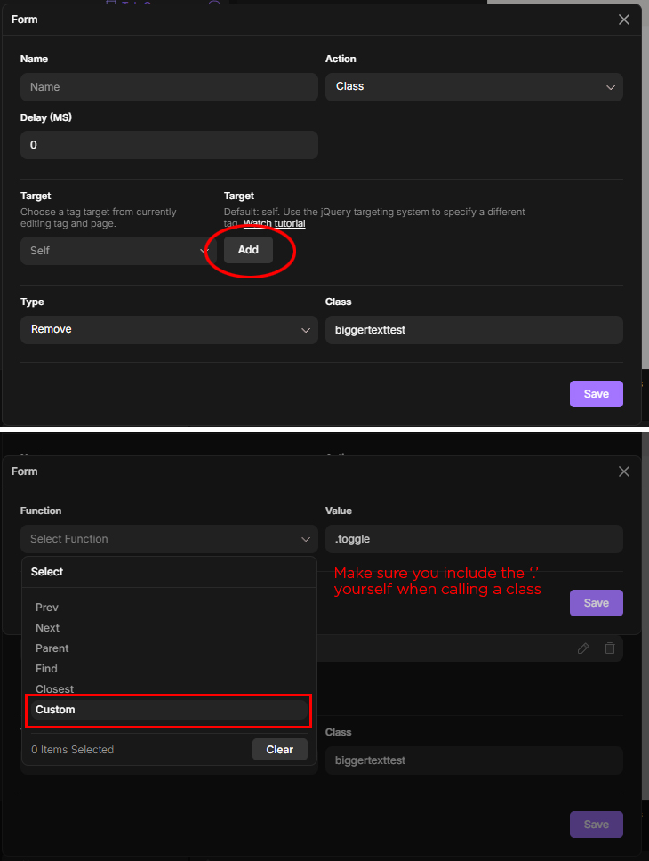

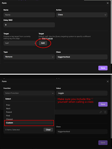

I understand. When selecting the class, there’s an ‘add’ to the right of the dropdown you’re currently using to select (for example) ‘Heading 4 (H4)’ etc. You would use this option instead of the Target>Self dropdown. Within that, you can chose a variety of options of which ‘custom’ will allow you to type in the class you’re looking to affect (make sure you add the class identifier ‘.’ as well). This should allow you to now call the .toggle class (or whatever your naming preference) and go from there. I’ve included an image in case my description isn’t sufficient.
Is this what you are tryiing to acheive?

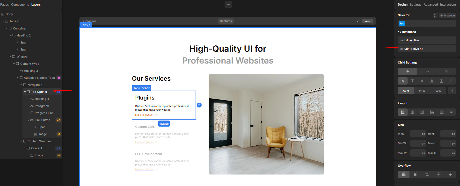

If yes, you dont need interactions, all you need to do is to use dh-active class and target h4 inside, and set font-size to bigger size. I did it for your project, you can customize now font size whenm you select tab opener and use dh-active h4 instance.
