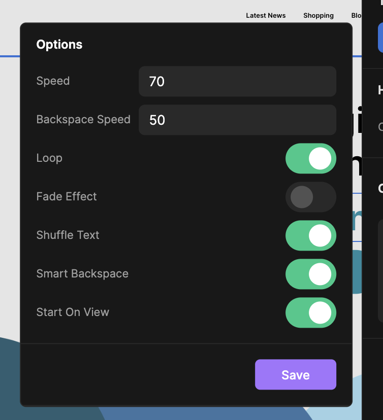

hey , the stuff actually worked for me. but now the type.js doesnt start loading untill the user scrolls. can this be fixed or?
Since the animation is already at top of page, you can disable “Start on View” - last option and it should work.
this worked, thanks very much!
