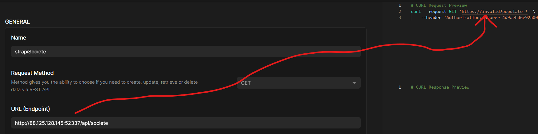

Most often request fail to execute on http://noelweb.hd.free.fr:52337/api/societe
Is there any type of limit on your end?
I’m suspecting free.fr to have put a limit on their “free” domain names. I’ll try to change it with the IP address
@xmasrock
We are not allowing IP address as URL.
Give us some time to investigate why is this happening. It may be our servers limit.

while I’m in the Rest-API screen, it’s a bit strange to have an “update” button on the different sections (PARAMS, HEADER, …) and not on others
@xmasrock
Most of our system is based on auto-save, so we could also add those (params, headers) to be autosave too, would that work for you?
Also seems like domain http://noelweb.hd.free.fr:52337/api/societe is no longer working, I am trying to determine what was issue.

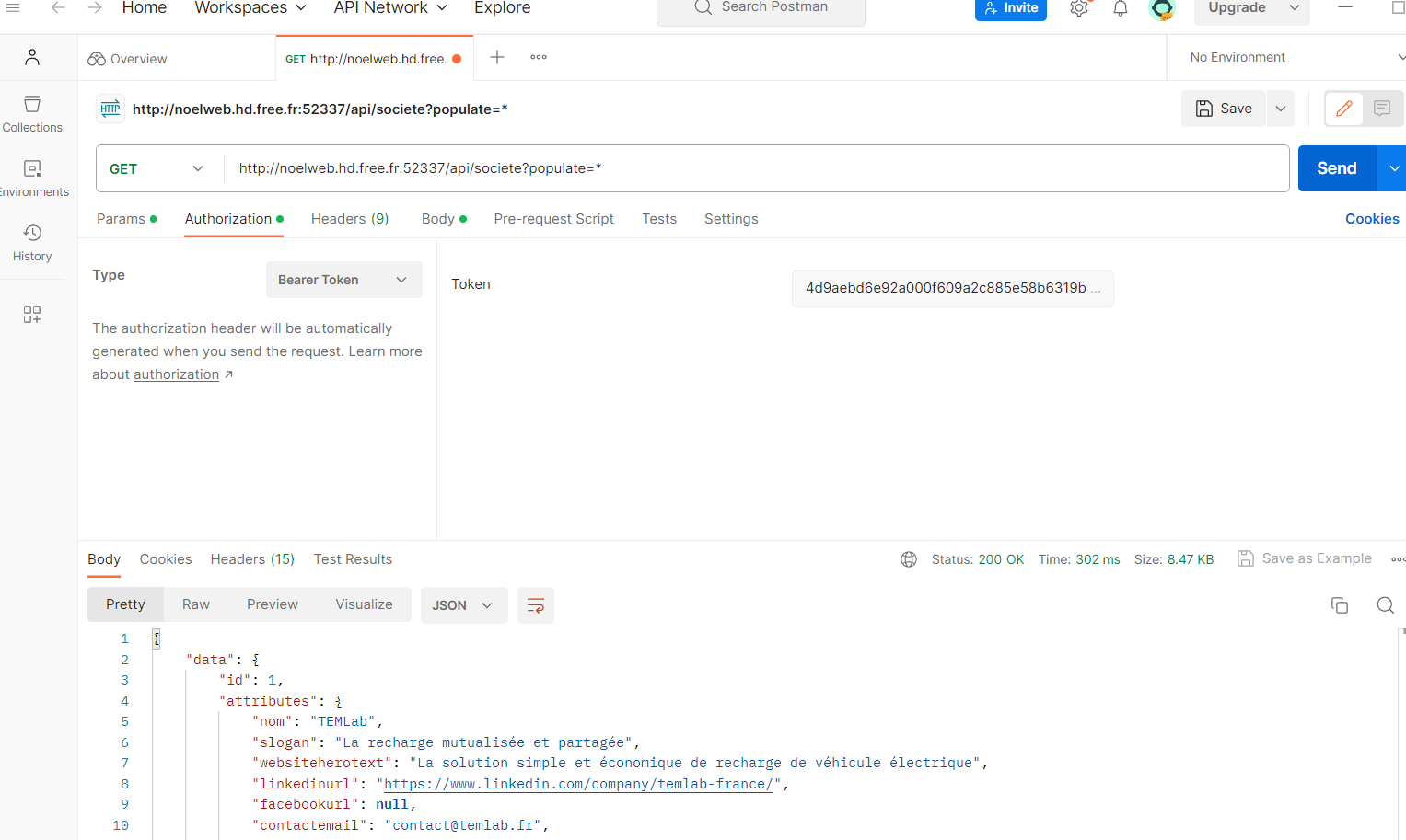

@dejan : I confirm that the data is not retrieved right now.
I’ve tested with Postman and it works well.

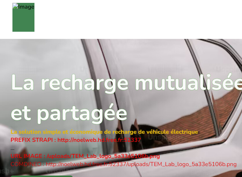

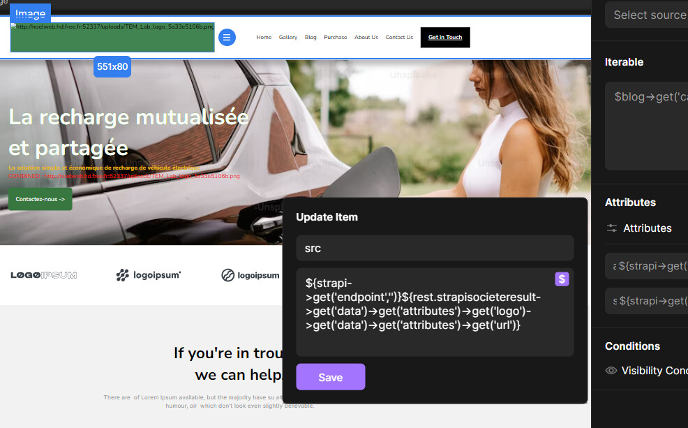

I’ve put this into a paragraph
${${strapi->get('endpoint','')}${rest.strapisocieteresult->get('data')->get('attributes')->get('logo')->get('data')->get('attributes')->get('url')}}
It’s not working, the first variable is ignored
the combined is now working with just :slightly_frowning_face:
URL: http://noelweb.hd.free.fr:52337/uploads/TEM_Lab_logo_5a33e5106b.png

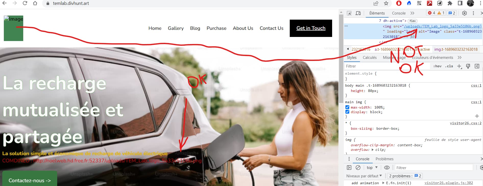

however, when using this on <img src= seems not working:
Looking at the generated site, the prefix is removed:
